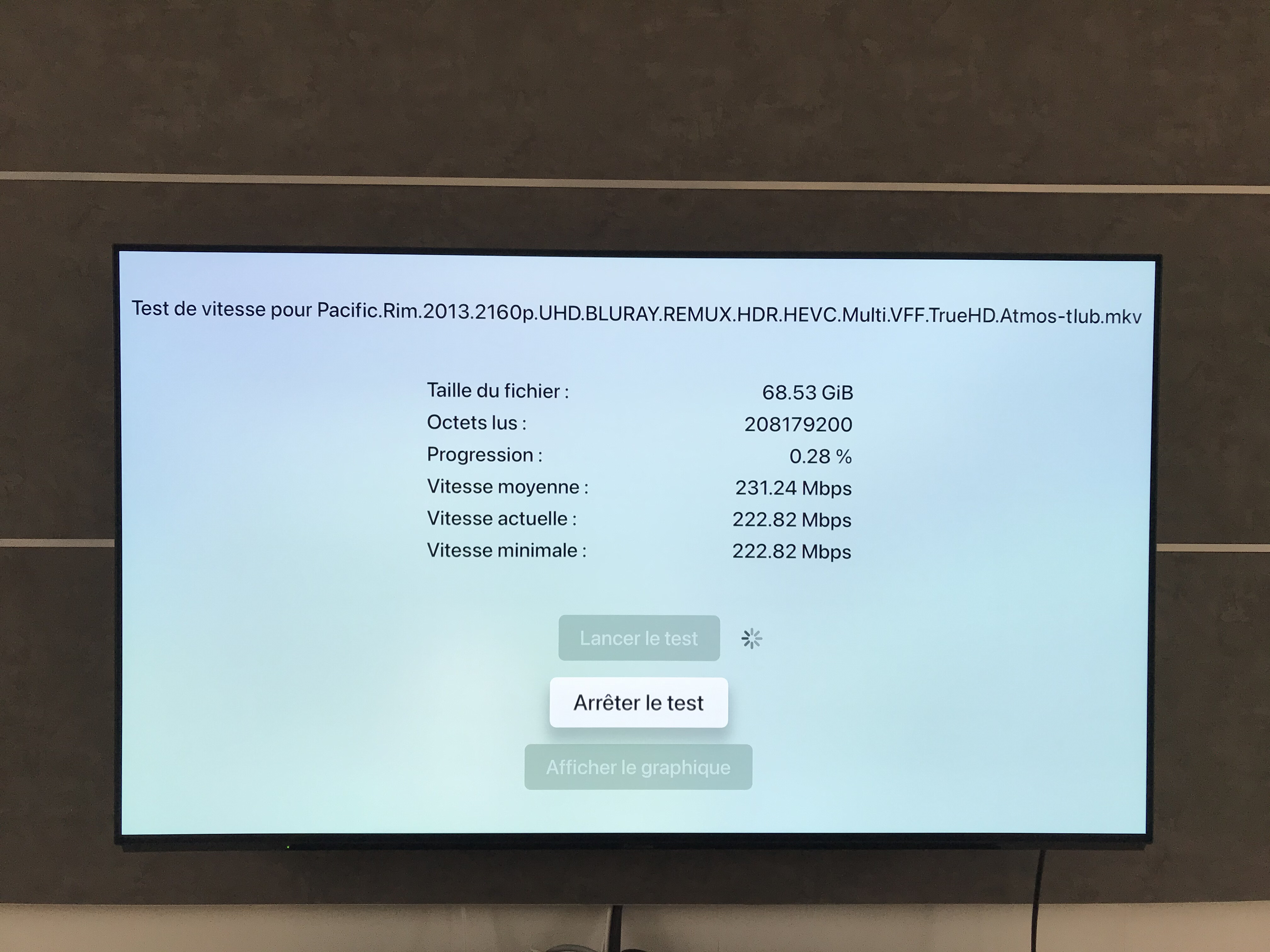

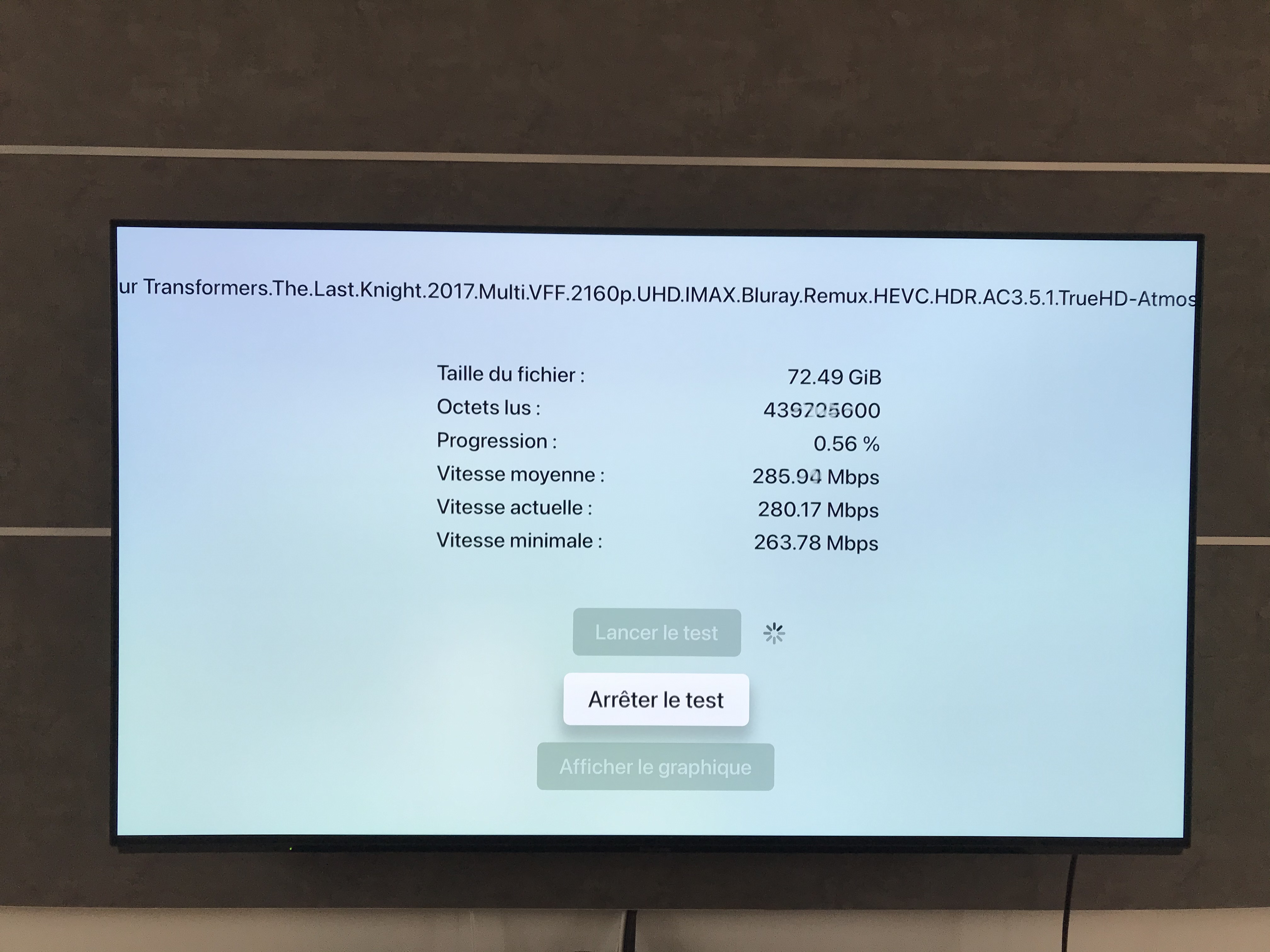

When you do a speed test in Infuse could you choose a different video and see what you get for speed in Infuse? Maybe a few different videos just to have a sampling.
Hello,
See here sole samples of different speed test on 4K and 2K movies :
Stephan
