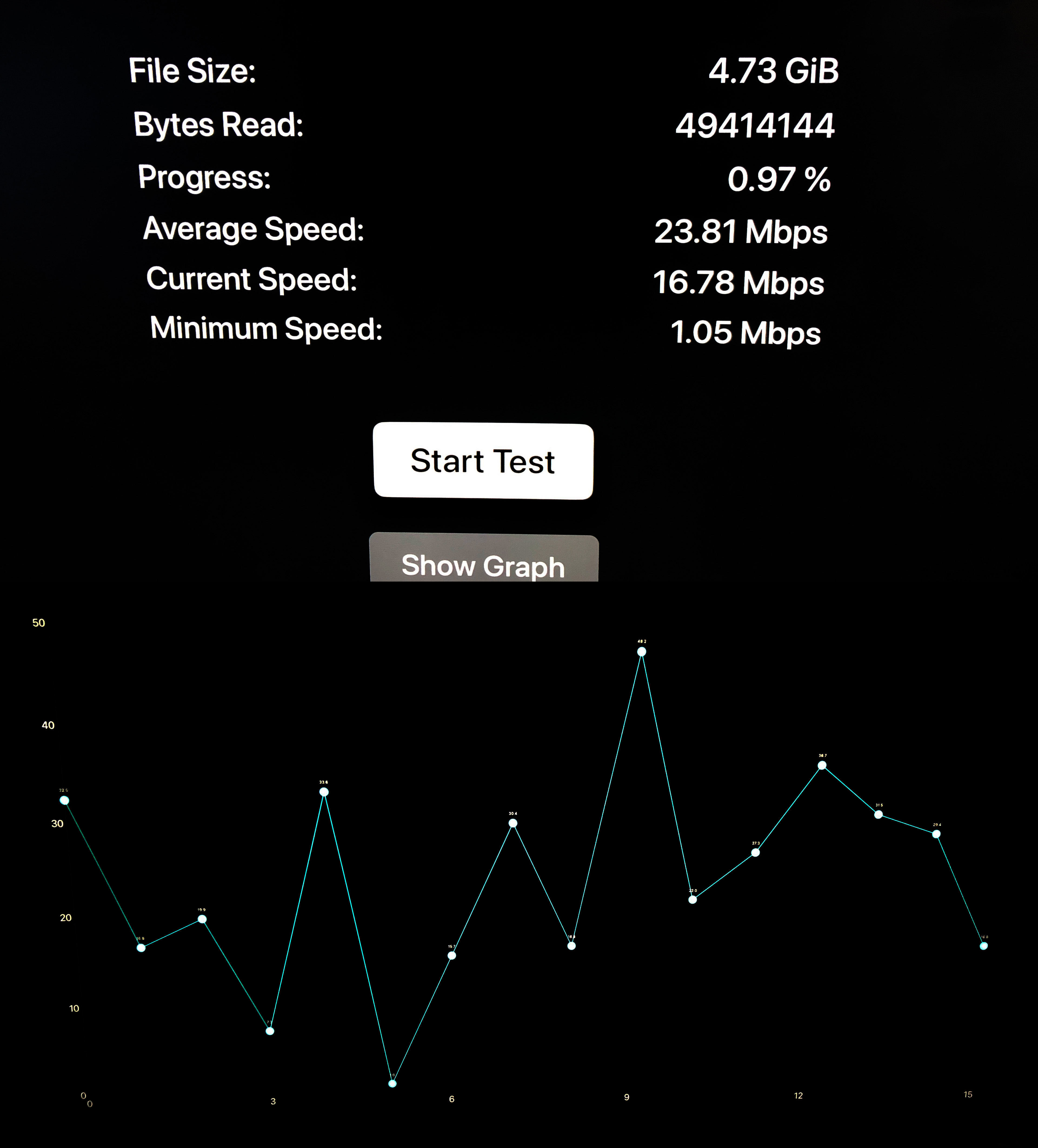

Can you share a screen cap of the graph after running a full test on one of the problem files? Also a screen cap of the result speed numbers of that same test would help.
I didn’t bother with waiting for the whole file, since that would take way too long. Hopefully this will suffice!
Same device according to speedtest.net averages about 980 down. This sounds about right, since I have a 1Gb connection and all my wired devices average that speed.
Thanks for your help!
The speed tests run considerably faster than the actual video and will give a better graph of what’s going on. With less than 1% it could be several things, first thought would be that something on the server isn’t allowing the transfer to Infuse as fast as needed.
A test would be to try sharing from the server via say SMB instead of jellyfin and see if that changes how the speeds go.

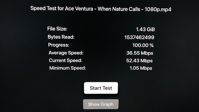

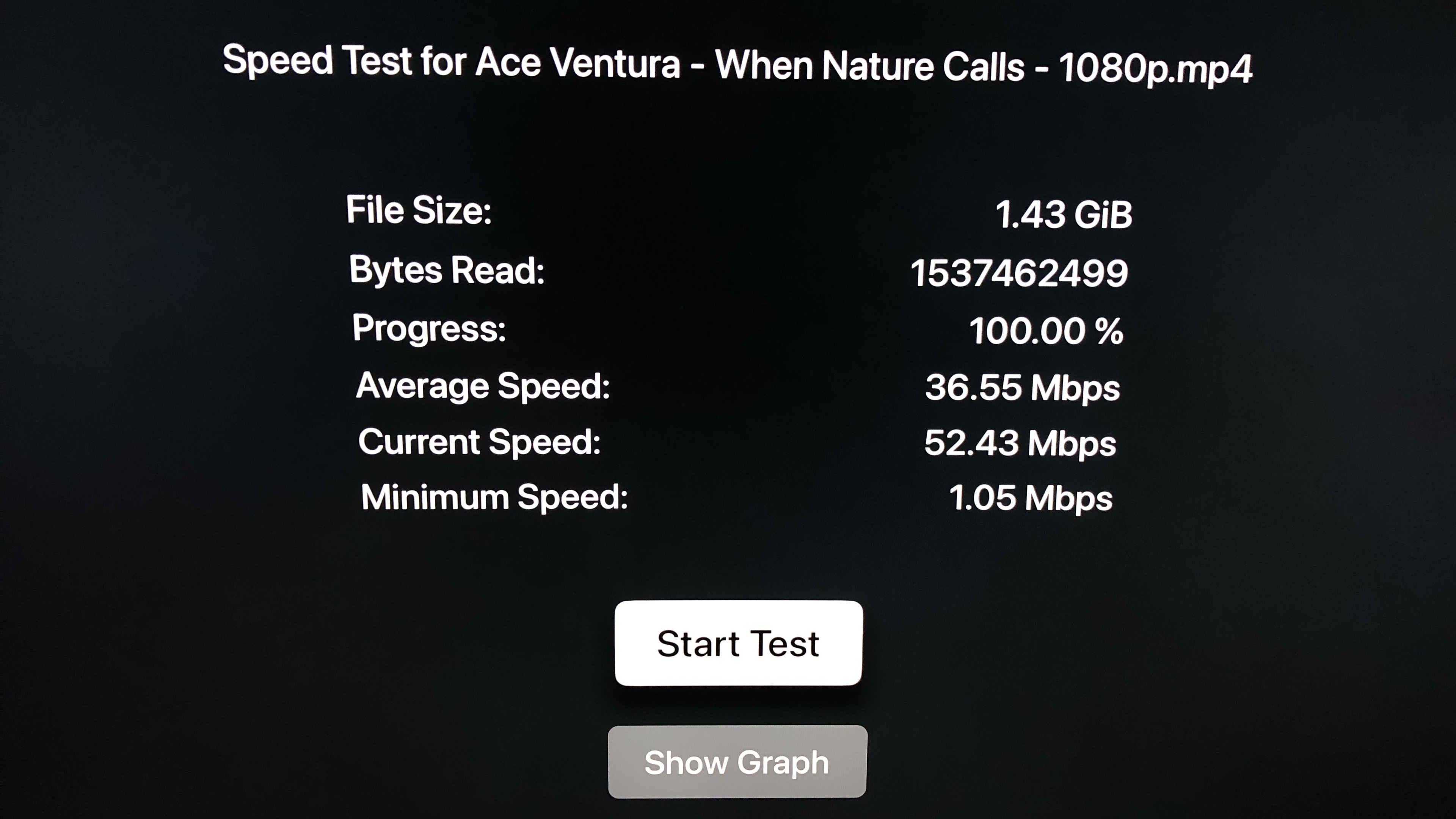

Found a smaller file to test, so wouldn’t take too long.
It actually averaged better, but still nowhere close to where it ought to be.

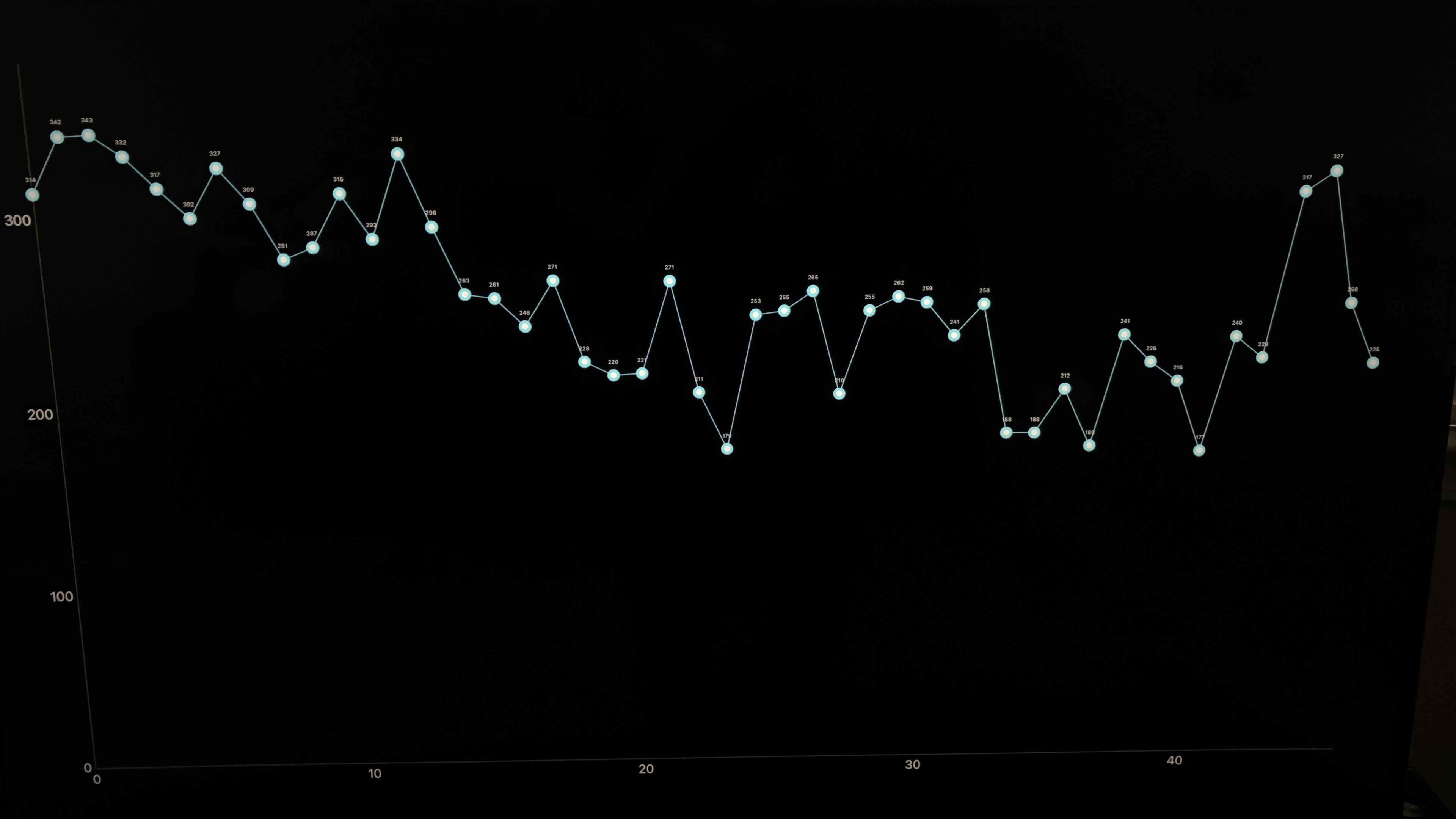

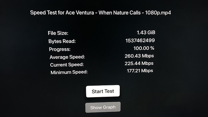

I’ll try via SMB only and will report back. Thanks!
As an SMB share, I get substantially better results. Not quite as high as I would expect, but I suppose this could also be a limitation of the storage media. In that case, this looks about right.
