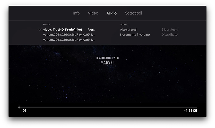

Again, I am very disappointed that this hasn’t been fixed in v6!! Is it really so hard to analyse the videos metadata, extract the kind of audio each track has and make it readable? MediaInfo does it, the info can be extracted from ffmpeg. Last night I wanted to change audio on a movie, and there was a rotating string never ending, with the info about the audio codec (and language) just at the end.

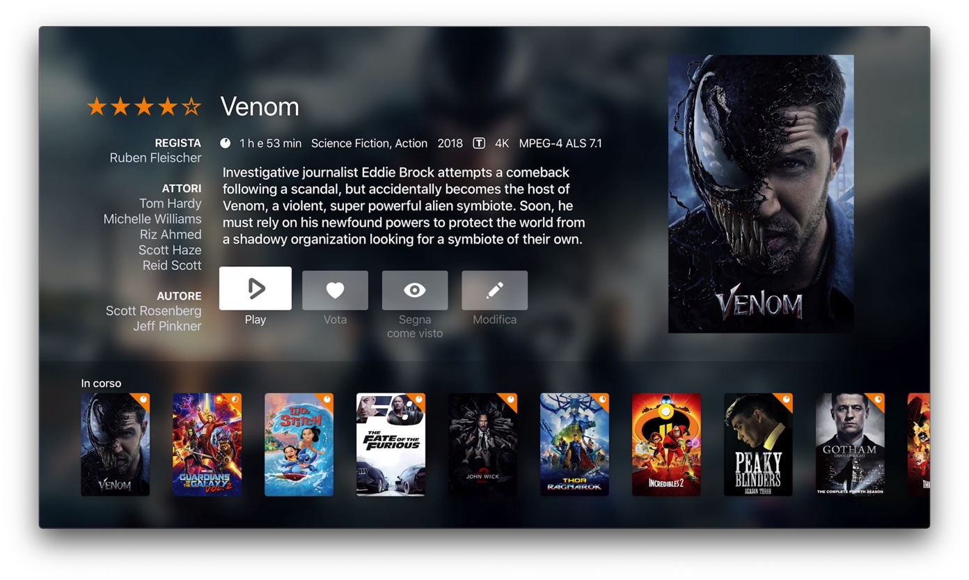

Not to mention that even in the movie page the audio description is cryptic. What does it mean “MPEG-4 ALS 7.1” (although I suspect this is a bug)?
See attached screenshots.
Have you updated Infuse to 6.0.1 or higher? There was a fix for mislabeled codec in 6.0.1.
Yup, Infuse 6.0.2 here and I am still getting “MPEG-4 ALS 7.1” in the movie page. Nothing changed in the Audio menu either.

Ok, it worked for the main page! I have got TrueHD 7.1. It still shows the long name in the audio track list in the Audio menu, though. Which is my main concern. Is it working as design or still a glitch?
PS: Since I still had plenty of movies showing ALS 7.1 I have just deleted the whole metadata, now. Hopefully the iCloud synching will make the metadata rebuild a breeze? Not sure how it works.

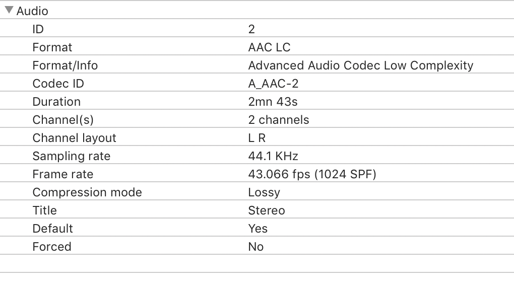

The text shown in the track list is the ‘Title’ tag taken from inside your videos.
Generally this is something useful like: Surround 5.1 or Stereo - but it looks like this particular file has the file name listed, which is odd. If you like, you can run one of your videos through MediaInfo to see what it says. A screenshot with an example is attached.

  1. Rebuilding (after deleting) all metadata didn’t clear the audio tags for some movies. I have noticed that if I click in a movie and then go through the list on the bottom, if I get a spinning gear then it shows the right audio codec (usually TrueHD 7.1), other wise if it shows immediately all info on the top, I still get MPEG-4 ALS 7.1. I have to manually edit the metadata (as you suggested) and click the correct movie name

Since in the audio menu I get this format "[Title] (TrueHD, [Language]) where [Title] and [Language] are like the ones above, I suppose that you could just ignore [Title]?
