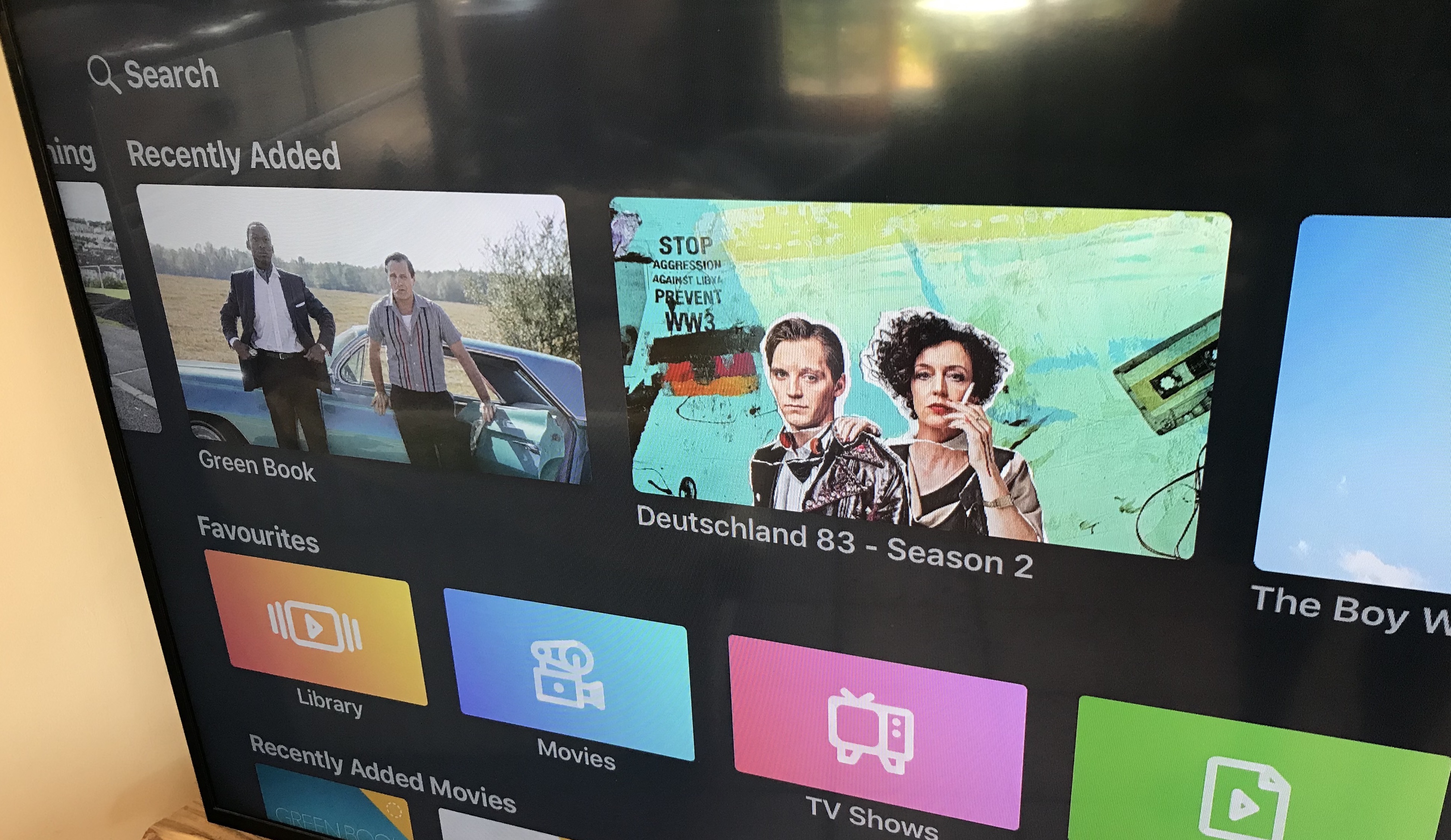

I have an small issue that I can’t figure out with TV series poster.
The poster appears in the main view (with movies, recently added, watching etc…) but when I go to the TV series tab, it shows a generic grey icon of a folder. I have 3 other series that display the correct poster but one will not show the poster.
I have tried adding a jpg in the folder, it doesn’t help. The embedded metadata option is off.
What really baffles me is that it found the correct poster for the main menu. Any suggestions?

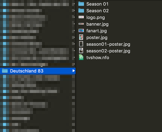

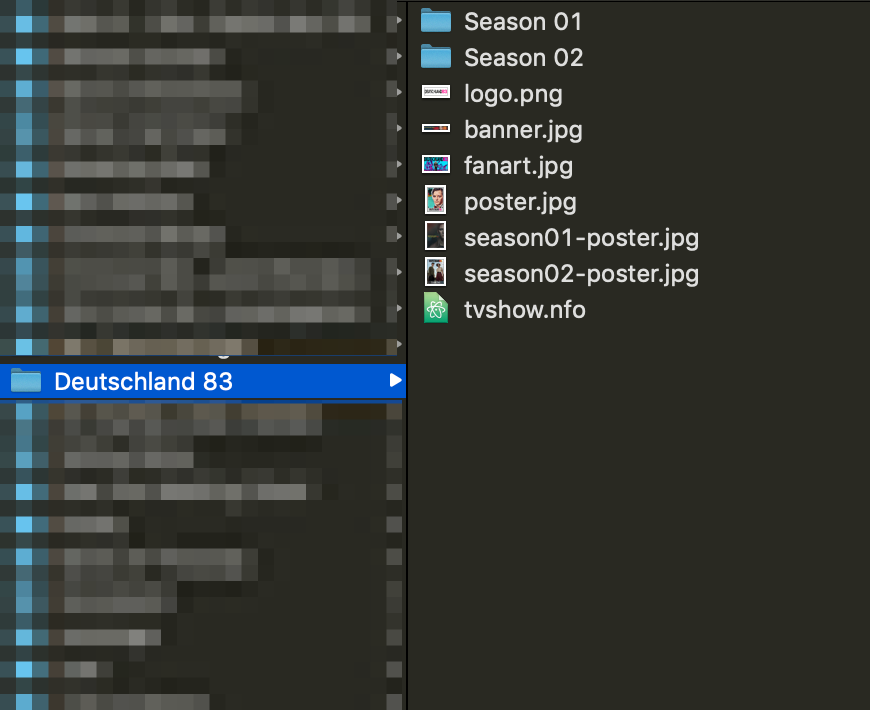

Please check the folder where the series is stored
It should be like attached
whereas
fanart.jpg is the image shown in main screen (your img_2752.jpg)
poster.jpg is the image shown in tv series tab
season01-poster.jpg would be shown in tv series tab in case you have organized files in subfolders per season for season 1
I guess poster.jpg is missing (or one of the season posters)
You can add them manually :slight_smile:
The names of the files are important
Please check

Quick question.
Are you browsing your shows via the pink TV shows icon on the home screen, or through an orange favorite/folder icon?
Overriding TV show artwork is only available when using the library, which is accessed through the orange Library icon, blue Movies icon, or pink TV shows icon.
