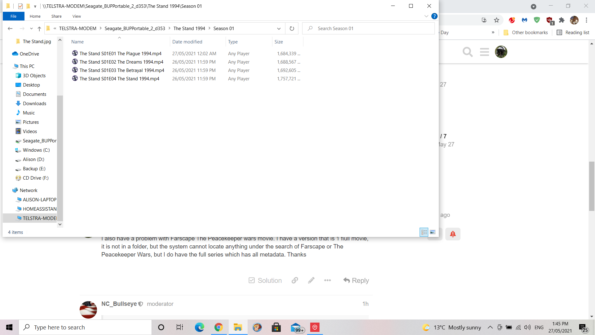

I have edited the files accordingly and the folders. I am able to fetch the metadata for each of each series. The problem now is, if I edit metadata for the 1994 series, then do the metadata for the 2020 series, it then overwrites the metadata for the 1994 and visa versa. They continue to interfere with each other.
Here are a couple of screenshots. You can see the directory of how I named the folders at the top. Can I do anyhting else to make this work? They still seem to be getting confused.
YAY! I have it working thanks to all your help @NC_Bullseye
Both series shows the correct number of episodes and images. They also now updated the cover picture and are also available in the TV Shows section. Thank ou for your help. I used the following format as you suggested
The Stand, Season 01, The Stand S01E01 The Plague 1994
The Stand 2020, Season 01, the.stand.2020.s01e01.the.end
You can try taking the 1994 off the series folder. That may be the issue.
