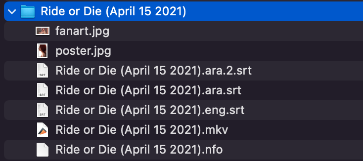

I tried to add the month of production to the title, but, without any luck.

Also how you have their files named?

Non of them in the same main folder, I thought that will help but, no luck

Just to try and redeam myself on this, one other thing that looks off is the “posters” and “fanart” should have the movie name as part of the file name like “Ride or Die (2021).jpg” and “Ride or Die-fanart.jpg”

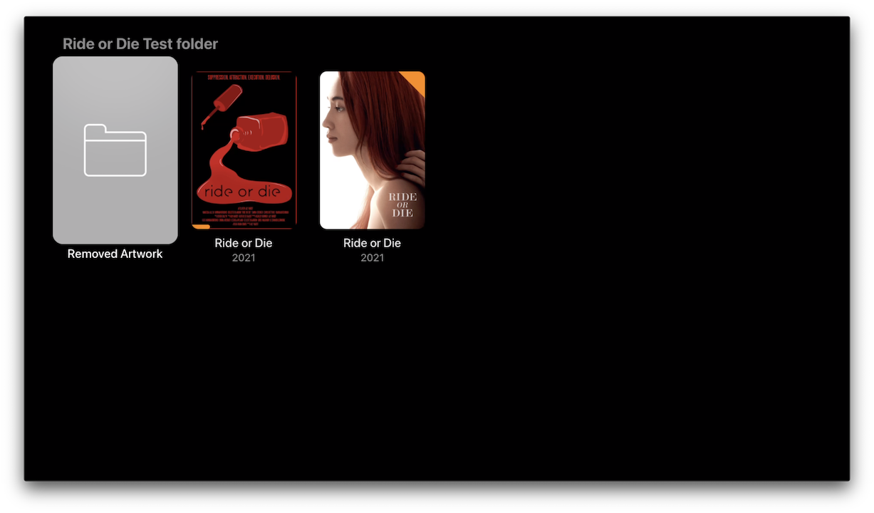

Okay, here’s how I got it to work as wanted.
First, I changed the file names to this.
This gave me the correct custom artwork for both including different fanart and different posters. This did not produce any textual metadata. Then by doing an Edit on each and selecting the correct movie in the edit they both had their respective textual data.
Then I play a portion of the first one and stopped. The other movie did not show any progress and could be watched at a different time.

and both movies are independent after you do the edit and select the correct movie.
Note the different watch status on both.

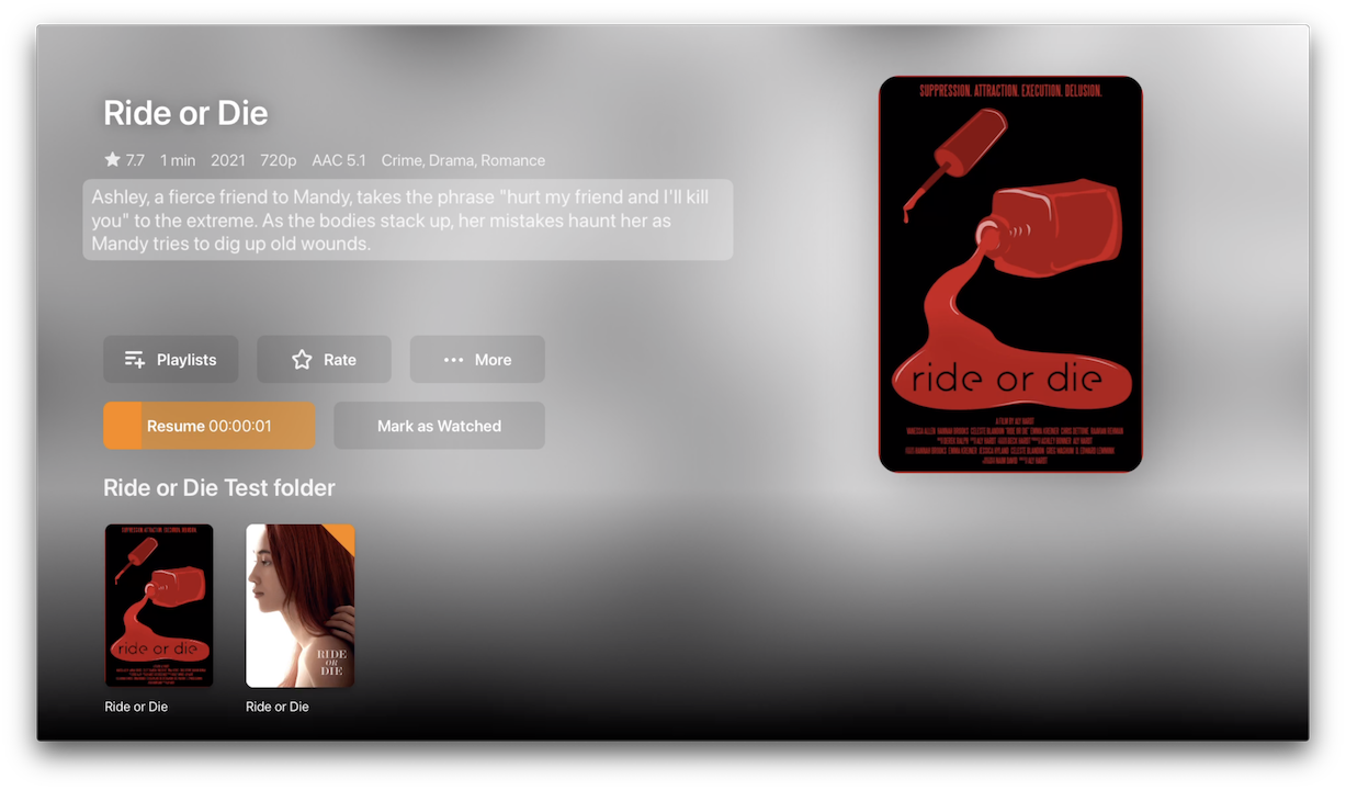

Edit to add:
Here are the pre-playback screens for both, note the artwork and fanart (background) are correct as is the synopsis and watch status.
Thank you for all the suggestion after deleting the day from the movie title name now infuse separate between them
