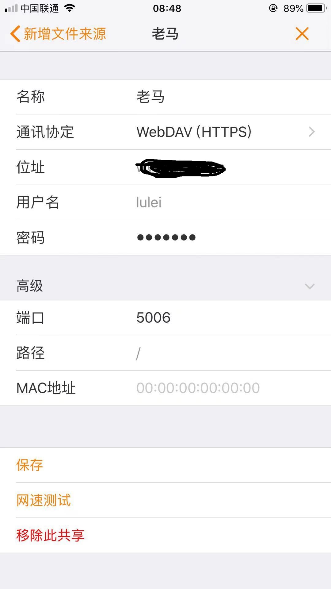

Hi, Same connection info, can not using WebDAV(HTTPS) access Synology server, but Npalyer works.
Port:5006
Path:/
Mac:00:00:00:00:00:00

infuse config

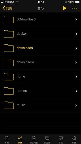

Nplayer config

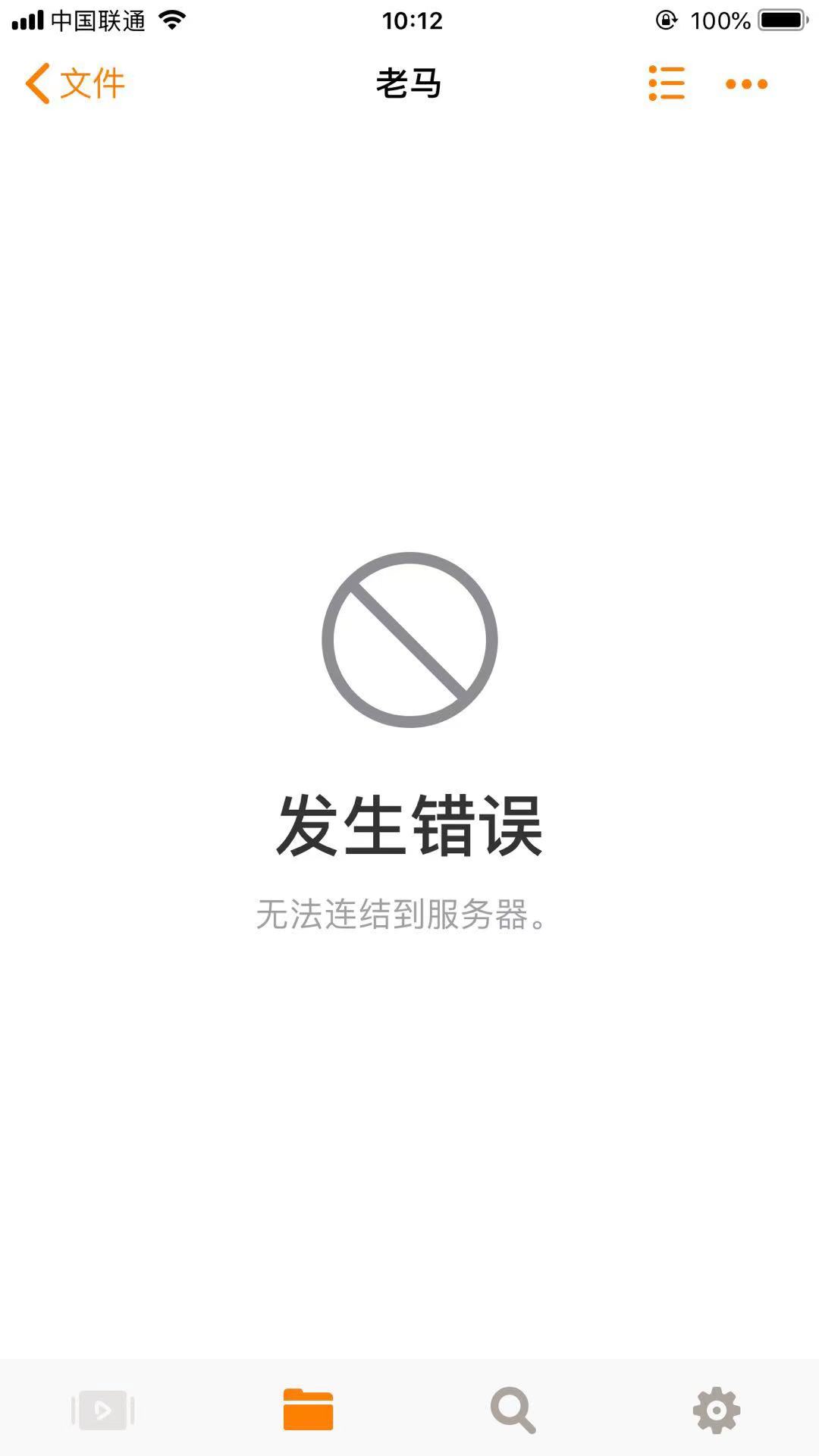

infuse error
Nplayer explorer

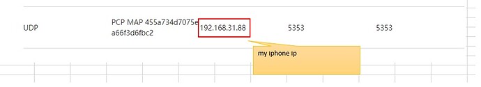

The infuse port is 5353, is’t it? The reaon that can’t access to Synology Server is likely the TCP protocol not work.
In my router upnp list only has UDP protocol
