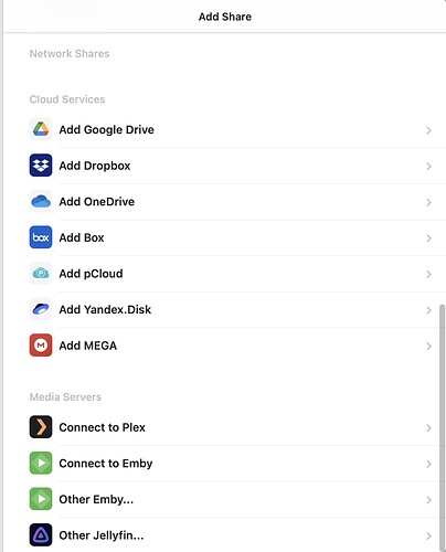

What protocol is Jellyfin Media Player using? I’m using SMB when I stream content at home from my QNAP. Infuse is running on my ATV, iMac and also on my iPhones. All using SMB.
I don’t know the technicalities well enough to tell if it’s using SMB or other protocols.
The most relevant detail I can recall is that when adding my server to Infuse, I had to fill in <IP address>; whereas when adding to Jellyfin Media Player, I had to fill in <IP address>:8096. In both cases, the <IP address> is the virtual IP assigned by Tailscale.
I don’t have a Jellyfin server but Infuse seems to support talking to a Jellyfin server so you you should be able to have Infuse talk to the Jellyfin Server just as the Jellyfin Media Player does.

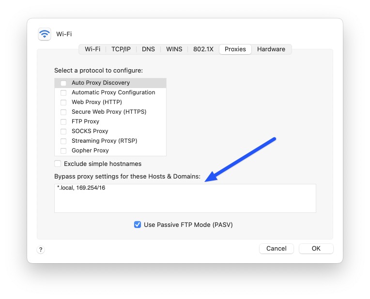

I’m guessing you’re setting the proxy in this dialog, did you put in an exception for the IP used to access the Jellyfin server?
I didn’t put in my Jellyfin server’s Tailscale IP in that box. But I think these exception rules should affect Jellyfin Media Player (the client) and Infuse in the exact same way, right? In other words, even though I did not put the server IP in the rules, Jellyfin Media Player has always been able to bypass the system proxy and connect via Tailscale instead.
I’m not one bit surprised that the Jellyfin developers program their own client to scan network interfaces to see if the client can detect a Jellyfin server:-)
Why not give it a try and add the local and tailscale IP’s in the dialog. There is no risk and only the upside that it might solve the issue.
Thanks, this method indeed solved the issue for me. (Sorry for delay, I was destracted by some IRL stuff and forgot to reply.)
Still, Infuse is the only app that had this trouble before I added the IP in the dialog. All the four or five browser I rotate between, Jellyfin Media Player and transgui were able to do it.
