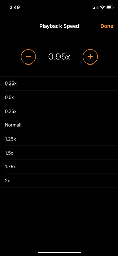

If you highlight playback speed in settings and then swipe left or right on the track pad you get .95 and tons of other options.
So you can change your playback speed in the settings section of infuse home screen, or you can set it from each individual movie when you swipe down on remote.
To get to 0.95x you have to press the (-) button. You are correct, the preset speeds are 1, .75, .5, and .25x.
This is from iPhone, as I’m not in front of my aTV. Swipe left or right for aTV speeds.
Oh, thanks! Had no idea. Are there more ā€œhiddenā€ settings like this? Guess I’ll have a look around.
I should also add that if you are playing a video and swipe down and select video you will also see a playback speed selection there and it’s controlled the same way, either click on it and select one of the options or swipe on it repeatedly and you’ll see other in between speed options.
If you’re seeing strangeness in only certain videos you may want to check the playback speed here since it can be different from the global setting in the settings menu.
