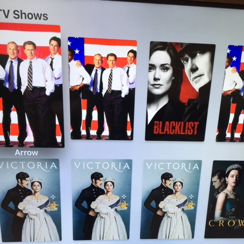

In recent months, the infuse library is displaying random artwork for both tv series and movies
My entire library (300+ movies and 2500+ episodes ) was cataloged and displaying beautifully previously so I know that my file naming and library structure is correct.
I now find that the artwork changes seemingly randomly - so some or all series will show artwork for say westwing, or some movies will show artwork for harry potter. The scenes from episodes also change somewhat randomly. Generally if i play a movie, the artwork for that movie will correct itself, but another group of movies will start displaying the incorrect artwork.

Hi the restart appeared to work initially but about five minutes later, the issue resurfaced.
I then cleared the metadata and rescanned my shares, which finished about 30min ago. Im happy to report that the problem seems to have gone away.
Significantly the metadata which had been indicating 7GB has now dropped to about 750MB
Hope this problem is now fixed permanently
It almost sounds as if there was a glitch while Infuse was getting metadata and it garbled it. Glad it’s working again and thanks for getting back to us.
