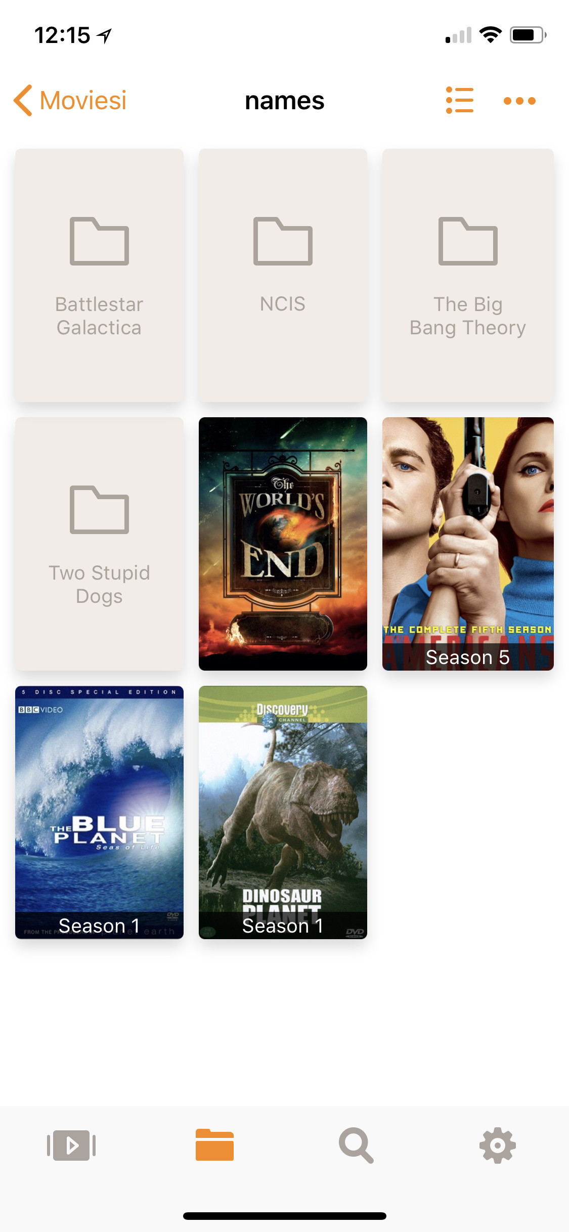

Here is my ipad showing some of my documentaries. The ATV4 exhibits the same images:
https://i.imgur.com/03mcAbP.jpg
Note the arrows. The red arrow points to The Blue Planet. Named correctly and all info scraped correctly APART from the artwork which shows a wave. Where did that come from? If you look at both themoviedb AND tvdb, the only images they should be serving are these (the top three from themoviedb and everything on tvdb don’t even have the wave image to serve):

…but it gets worse with the Dinosaur Planet series. Look at the yellow arrow. Note, the artwork is in German for a start. Note also that “die letzten jahren der dinosaurier” means “The last days of the dinosaur” in English so it isn’t even showing artwork for the correct show.

So WHERE on Earth is Infuse scraping this random image from? Why is it applying it to a different language, different show item?
I have cleared the cache, refreshed metadata again, rebooted both ATV4 and iPad, made sure it’s all named correctly, removed hyphens, put them back, removed apostrophes, put them back, named the files every which way you want, renamed the files as per tvdb and moviedb correct titles…whatever I do, Infuse insists on serving up THE INCORRECT IMAGE.

Well that illustrates my point, you aren’t receiving the correct artwork either. The Blue Planet should not be a wave but a picture of a shark against a blue background as I mentioned in the OP. This indicates an issue on the tvdb server end (maybe when they went down for maintenance something broke?).
OTOH, you ARE getting the correct image for Dinosaur Planet which indicates that folder is an issue at my end - maybe in a .store file or something either on the media drive or in the ATV.
I have used the EDIT option to attempt an artwork refresh but it doesn’t work, Dinosaur Planet is stubbornly stuck on the German artwork for a different series altogether.

That particular artwork is the season level artwork (https://www.thetvdb.com/?tab=season&seriesid=74372&seasonid=7343&lid=7) that was top-rated by TheTVDb at the time it was fetched. This may be due to the fact that the ‘shark’ artwork only has a single user rating. The top rated artwork will change from time to time based on user ratings.
