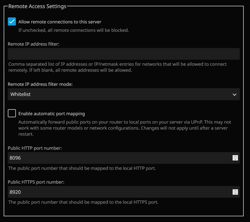

I use Jellyfin and didn’t set up anything special. If you are wanting remote access, like from outside your home, then make sure “Allow remote connections to this server” is enabled on the Jellyfin server (Administration | Dashboard | Advanced | Networking), and you’ll also probably need to setup port forwarding on your router.

Do you have anything set up within Jellyfin under Networking and Remote Access Settings?
No, just allow remote connections to this server. (I don’t have an ssl cert, so I didn’t enable https right now btw)
