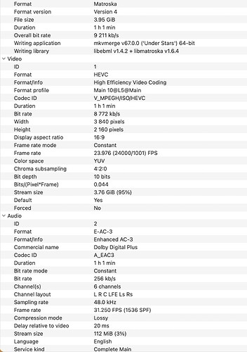

Lately I am having stuttering problems with various 4k files, it usually starts after a minute or two.
Not all 4k files are affected but I have both movies and series that are affected.
I am using Apple TV 4K 2nd gen. with the latest tvOS firmware
I have tried all the different cache types.
I have tried both latest infuse beta and the stable version.
Are there any known issues regarding this problem?
Here is the info from a couple of the files:

Can you provide a bit more info on what you are seeing?
When the problem starts, does it continue for the rest of the video or just for a moment?
If this happens again, can you send in a report from your device (and post the code here)?
If you’re seeing it with a specific video file, uploading a sample could also be helpful.
I AM SORRY! ::
Turns out it WAS because my files got corrupted on my external SSD.
Everything is fine now so i sincerely apologize.
