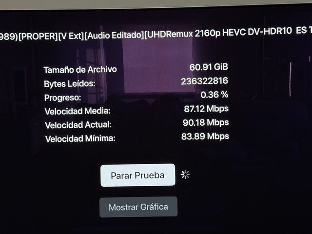

Can you show a screenshot of the Apple TV infuse speed test?
I’m on cable, and it used to give me much higher speeds, 200/300/400 Mbps, but now it’s stuck at 90 and won’t go any higher. I read files from a Synology NAS, and I’ve always used Samba. I’ve had Apple TV and Infuse for years.
Speed test on my Apple TV :backhand_index_pointing_down::backhand_index_pointing_down:

Also, could you run the speed test in Infuse and let it complete for a problem video? with only .36% that’s not much transfer time to evaluate.

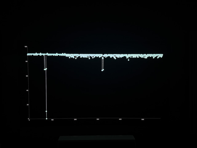

Also if you could do a screen cap of the graph after the 100% test.

Weren’t you having problems with 4K files? The first one you tested was a 4k file at 61 GB but only did less than one percent. Can’t you run that one again but complete?

Yes, always everything via Ethernet. You see, I ran a test and got 1GB. It doesn’t matter what file it is, 1080p or 4K, there’s always that 90Mbps limit. Can you see the graph in the first image? The link is crossed out. Can you see both images?
That straight line is very suspicious xdddd
Yes, I saw both images. The reason I asked to see the test run on the 4K was that Infuse may only need the 90 on the 1080. The 4K may show more limits over the longer test.
