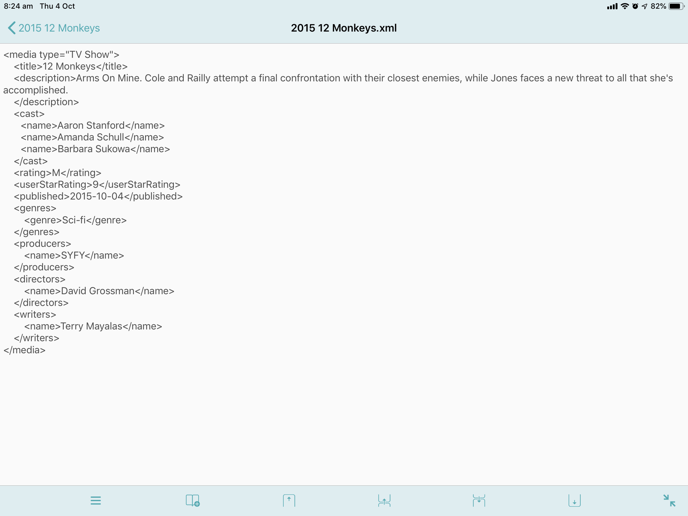

Hi, just trying to work out where your problems are occurring. I have quite a few xml throughout my tv show library and it is working as expected (one of mine is even a 12 monkeys episode too!). Are you matching the item to a series in the online tv database before updating the data with an xml? I have attached a screenshot of one of mine

I tried with one of my files and an xml and it appeared in the library by me doing the following:-
  1. Folder structure: Big Bang Theory / Season 1 / 2x files: Big Bang Theory.s01e01.mp4 … Big Bang Theory.s01e01.xml.
  2. I then clicked on edit and searched for the title and selected the TVDB listing (not xml). It will then populate the data via the TVDB. I know you don’t necessarily want this data but the library feature seems to like a basic match with the TVDB - I even have two shows in my library that do not appear in the TVDB but I have matched them with a random show then replaced the information with an xml.
  3. Now the series is recognised by your library, click edit again and select your custom xml.
  • I made sure Infuse initially scanned my file into Other to replicate your issue
    **Attached is a pic of the show as it appears in my library and the xml I used.
