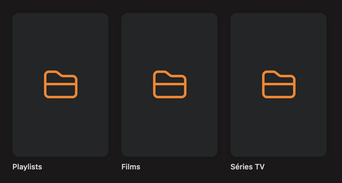

Also it does appear that I can browser the server just fine :man_shrugging:. Normally when a server is not avaible (if I have the Tailscale IP but VPN off for instance) it will just load endlessly.
So something is telling me that it is working, just not in the right way.
Also I found this post on the forum of someone who had a similar issue. But saldy his fix was using a VPN and in my configuration I have to use the VPN anyway, but who knows maybe that can help.

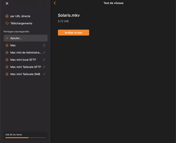

Here again, a proof that it is working and that I can browser the files but when clicking on “Start test” it will show “Stop test” for like 5 sec and then do nothing.
