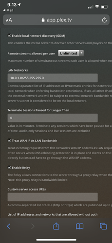

Specify your local subnet in plex server network settings
How do I do this?

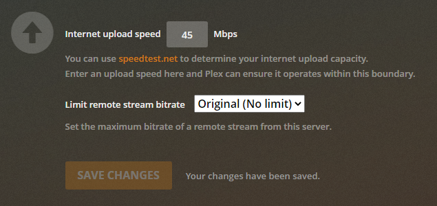

Attached is a picture of my Plex Remote Access settings.

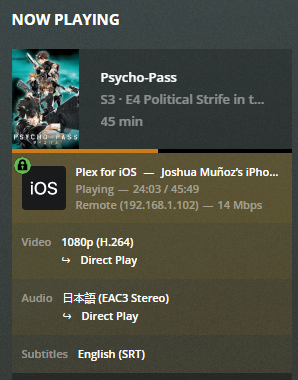

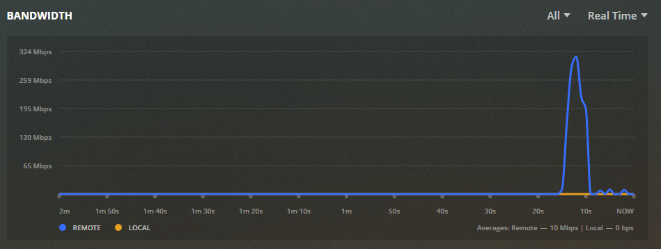

Opened a TV show on Plex in my iPhone, took some screenshots from the Plex dashboard, but cannot attach them to this edit (new user restrictions, still).
Now Playing:
Video: 1080p (H.264) > Direct Play
Bandwidth (Remote)
0 - 320 Mbps
Additionally, when I upped my upload limit to 1000 Mbps, Plex now says Not available outside your network. Your server is signed in to Plex, but is not reachable from outside your network.

Was just reading on the plex forum and they also said you may want to try just deleting the upload speed number so it’s blank. That should remove any limits. Don’t forget to save your changes.
This is in the plex server settings under network.
Just delete the limit number all together so it’s blank. Don’t forget to save.
Ah. I put the IP address for my iPhone (taken from my Linksys Network Map) to see if that would fix it. Also deleted any upload limits and saved. Still nothing. Very curious.
