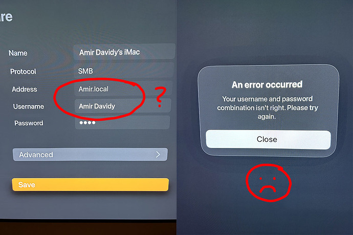

I can’t connect my iMac to the Infuse app on my Apple TV. I get the famous “username/password combination incorrect”. Can you please check out the screenshots and see what is the right username and password I should enter so it will finally connect? Thank you so much!

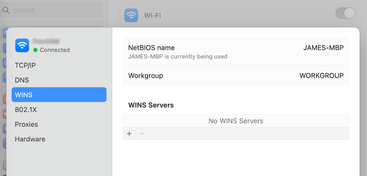

In recent versions of macOS the device name setting has gotten a little bit buggy, and doesn’t always stay in sync in the relevant locations where it is used.
You may check/adjust the device name found in the Wi-Fi (or Ethernet if you are using that) settings page as shown here.

Thank you! I tried my mac login username and password and it didn’t work :frowning:

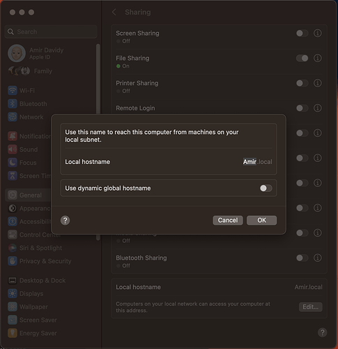

Thank you so much! so AMIR would be the username? and the password would be what? see screenshot please
The name shown there would be the device address.
The username and password would be the pair used to log in to your Mac.
