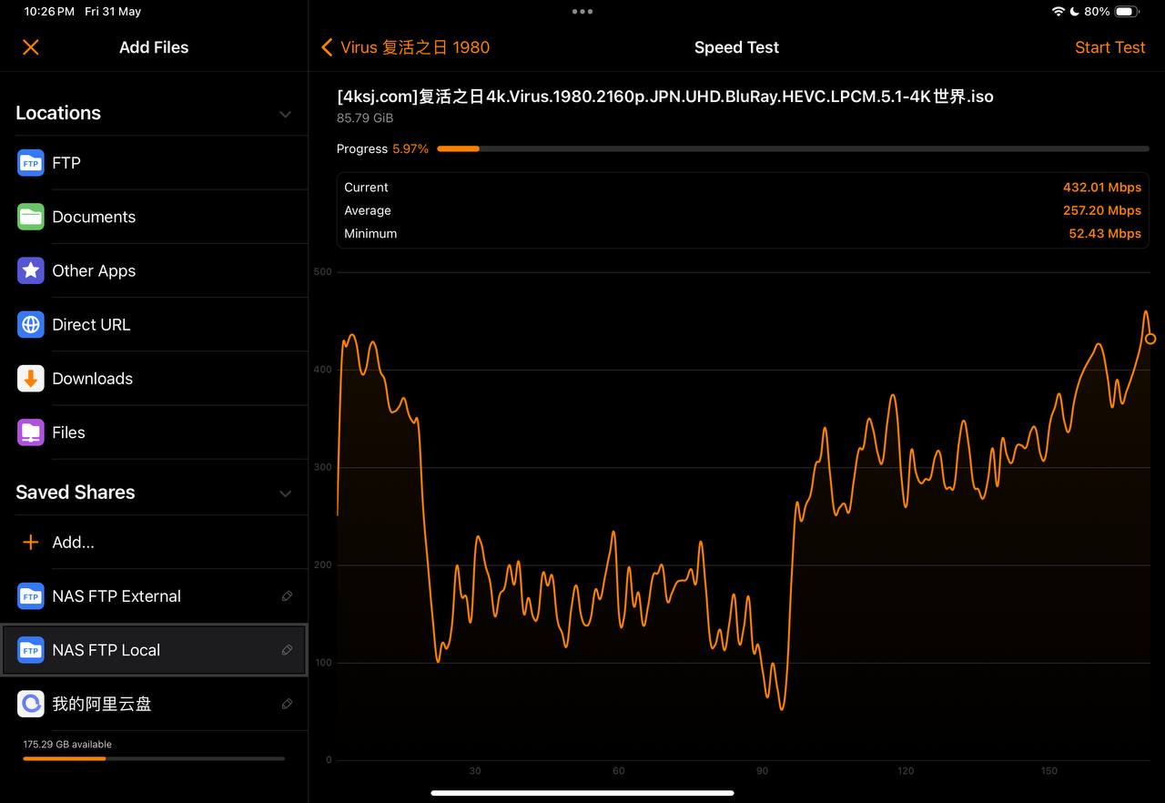

Have you tried a speed test within Infuse and see what it shows for that video? Let it run for the whole video if you can or at least a few minutes. Also posting a pic of the graph may help.
Also maybe the results of running one of those files through mediainfo and posting that here also?
Thanks for the quick response. Here is the graph.

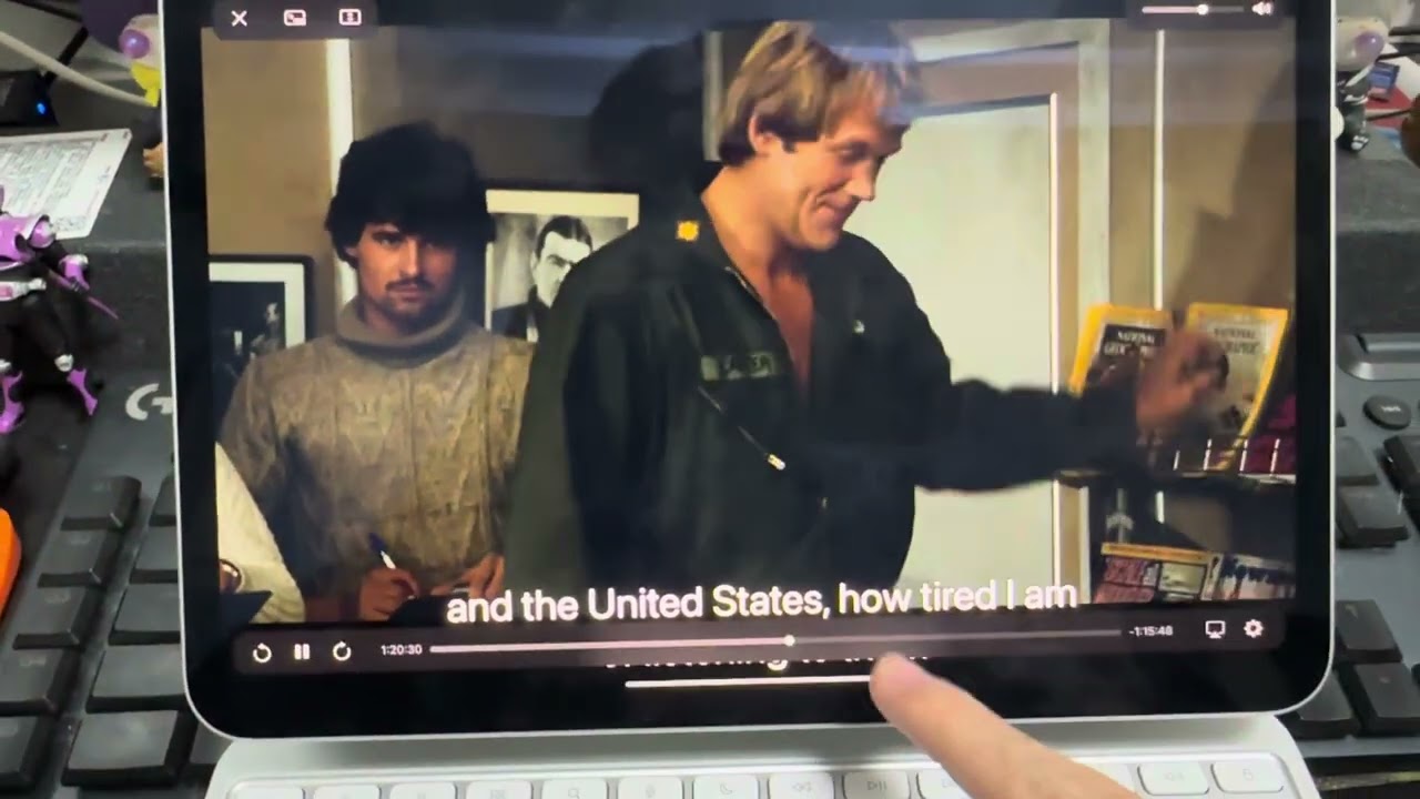

Here is the video showing the symptoms, as I felt it was hard to describe by words.
(Video might be blocked in some country due to copyright issue since I played a movie for a few seconds)

Ftp/WevDav protocols slow down with the BluRay structure. You have an Iso image of BluRay in the screenshot. Switch to SMB and this problem will go away.
