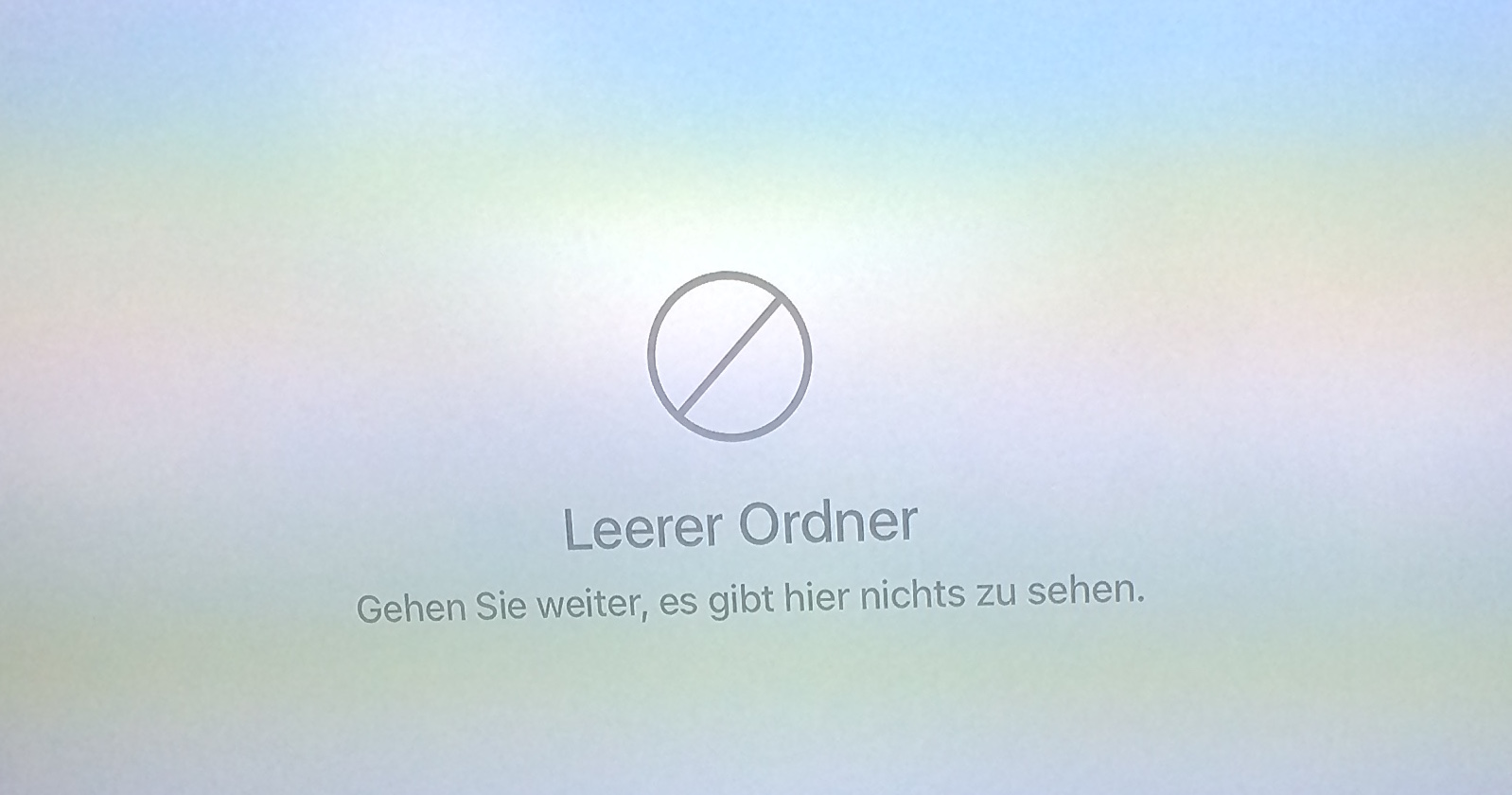

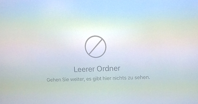

Since yesterday Infuse iOS (several iPhones, iPads with 9.3.2) and Infuse tvOS can´t open folders on the DIskstation (Message Leerer Ordner - Empty Folder)
With DS File I can connect the Volume / Folders. Access via Safari to the DiskStation is possible too. Changing in Infuse to SMB let me access the NAS, but then Folders und Files looks strange.
Deleting Infuse and new installation without any improvement.
