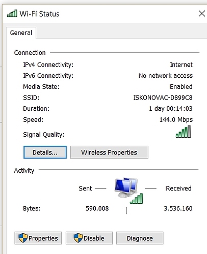

Here’s the screenshot of the ‘144Mbps’ I was talking about, I presume it’s the link speed between the router and the laptop. The xDSL (internet) bandwith is about 30Mbps, I know it has nothing to do with this but just to be sure here’s that detail too…

You’ve got a number of problems. First the Intel N-2230 adapter is 2.4ghz only according to the spec sheet. Also the router is a single band. You can choose 2.4ghz or 5ghz but not both at the same time.
The Air 2 supports 802.11ac with MIMO with a possible link speed of 1300mbps. The router and the network card can only go up to 144mbps in 2.4ghz mode. That great for going through walls but not so great from a bandwidth perspective.
