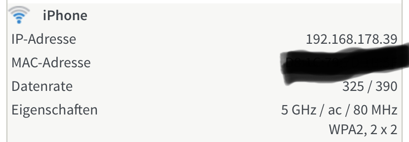

Update: At least my router says that the iPhone is in 5 GHz and also in WiFi AC mode. Also the data rate seems to be very fast and enough for 4K. See attachment. Very strange.
Update 2: My router has an iOS app for measuring the WiFi speed. In fact concerning the communication between Router and iPhone and have constantly about 170 MBit/s. So streaming a film with 61 MBit/s bitrate (audio and video combined) should work without problems I guess.
So maybe the problem sits between the Synology NAS and the router.
