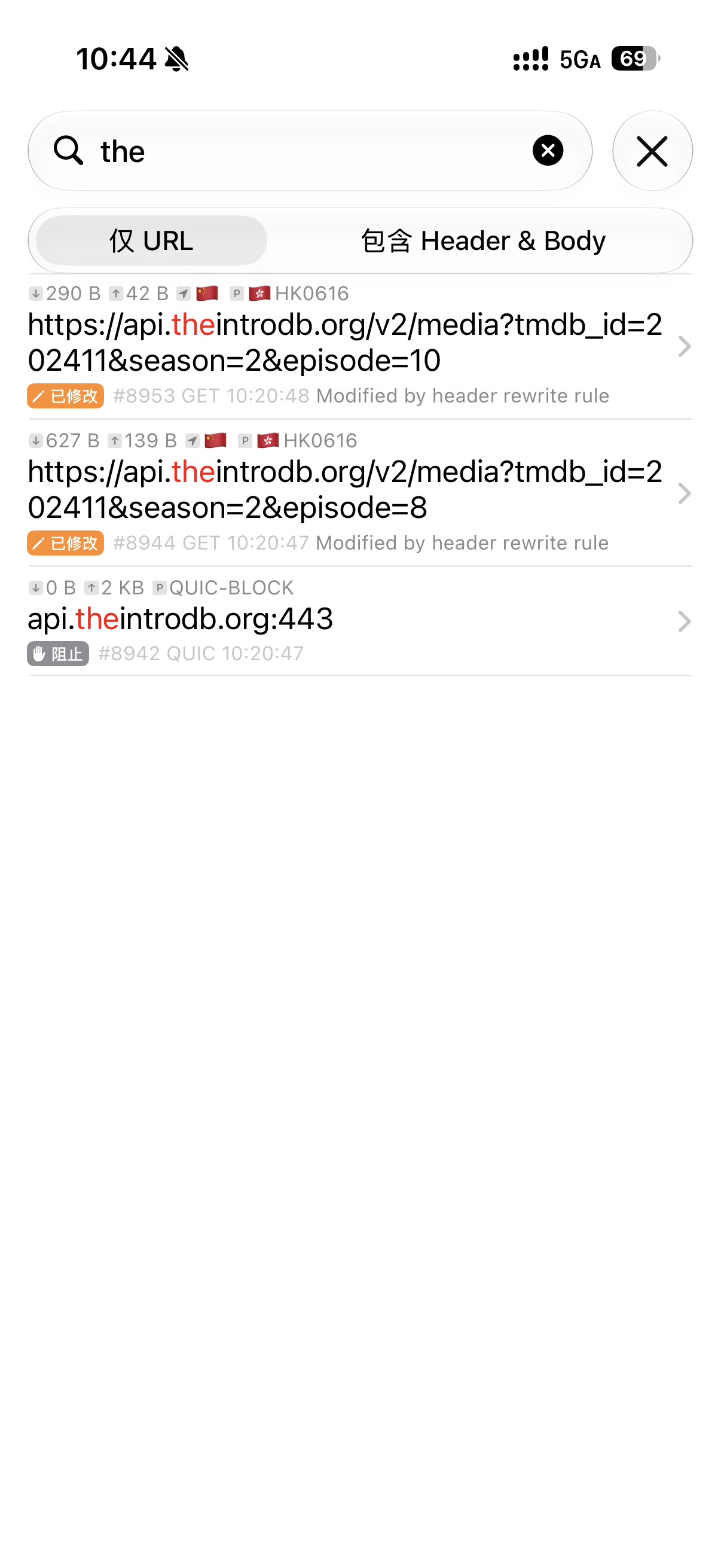

I found something weird by sniffing the network traffic. When I was watching episode 8, the data for the intro and outro of episode 9 didn’t even make a request. And after I finished watching episode 8, when it jumped to the next episode, it still didn’t request the data for episode 9.
There’s a huge problem with your intro/outro caching strategy.
code: BR59F
After I exited Infuse and entered again to click play, it finally made a request for the data of the opening and closing credits of the ninth episode.
