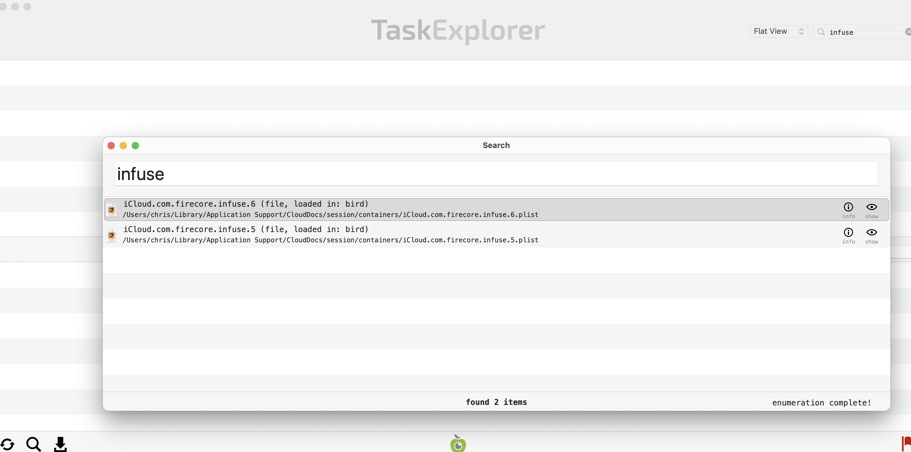

Also, to make sure my Activity Monitor app isn’t broken, I looked at this with TaskExplorer too, with similar results.
While Infuse is open, TaskExplorer shows it, including related dylibs and files:
When Infuse is closed, there are still loaded files shown in TaskExplorer, which might in fact be related to iCloud Sync or the Catalyst development framework (my assumption):
Regardless of the connection type, it still connects somewhere with Infuse being closed, which is – to me – unexpected behavior, even if the details might be slightly different.

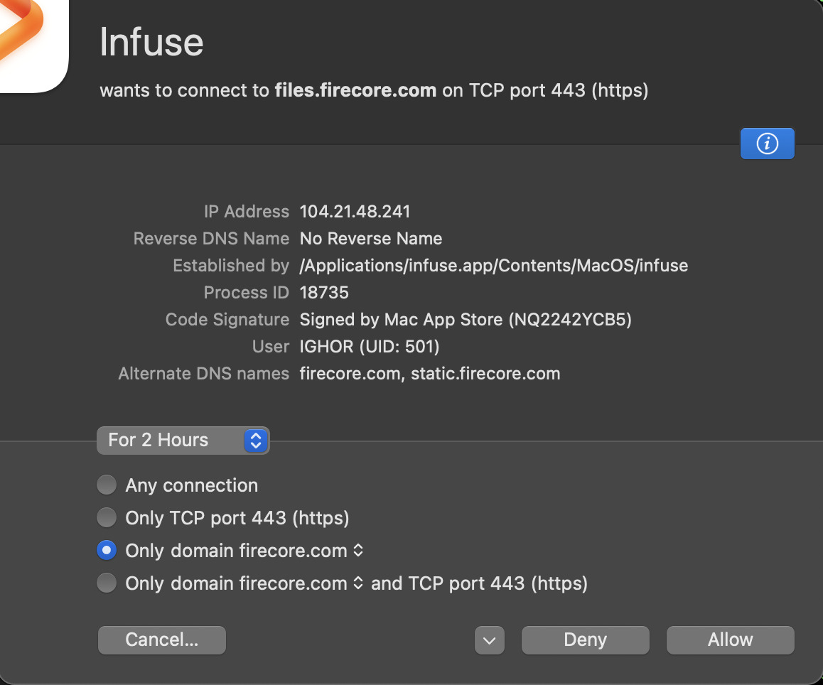

Just a note to say that I have noticed this same behaviour on my system. Mac OS 11.2.3 and the latest Infuse Beta 7.0.3535 plus Little Snitch 5.1.2. The reported connections when Infuse is not running so far seem only be to in.appcenter.ms.
What is happening here?
I did close app few hours ago, I have double check it is not running.
But the process is started sometimes and it tries to connect to your servers without my permission.
macOS allows for a bit of background activity from time to time. This is useful as Infuse can do things like scan for new files so they are ready the next time the app is opened.
it isright, but I don’t store files on filecore.com, I have no videos added yet.
So why it is connecting there without asking a permission?
This particular connection is a version check.
This is a bug as it’s not needed in the App Store version, and will be removed in the next update.
