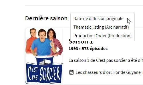

Hello
I know that I could arrange them with the default order S01E01 etc but there are 537 episodes in the season but I would like the Thematic order and I don’t know how to do it?
THANKS
Your only current option is to rename the episodes with S0xE0x to match the current air date sort order.
