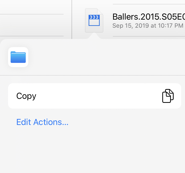

Thanks James. When I browse network files (SMb) and when I hit “share” as expected, Infuse is not an option that shows up =(. Only “copy”

Can you post a screenshot of where you are seeing ‘Copy to Infuse’?
AFAIK, as of Infuse 6, all share links should say ‘Open in Infuse’. Upon tapping, you will then be presented with a choice of ‘Play’ or ‘Save & Play’.

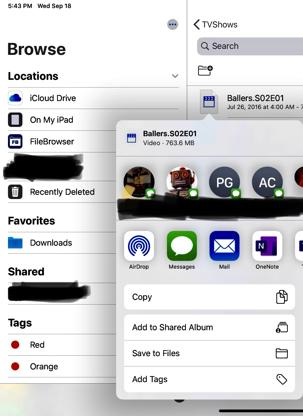

Here you go
Ok. So you’ll want to add Infuse to the favorite list of apps.
To do this, simply scroll to the far right of the colored list of apps, tap more, tap edit, and then select Infuse from the list of suggestions.
Weird, it works for some files but not not all depending on directory. These are all different folders on the NAS (SMB). This file in a different folder has no option for Infuse or any other app. Very confusing.
Looks like this is ipad 13.1 beta bug. Updating to Beta 4 today, and this issue at least goes away. Still some performance issues with the OS, but at least not an infuse problem.
