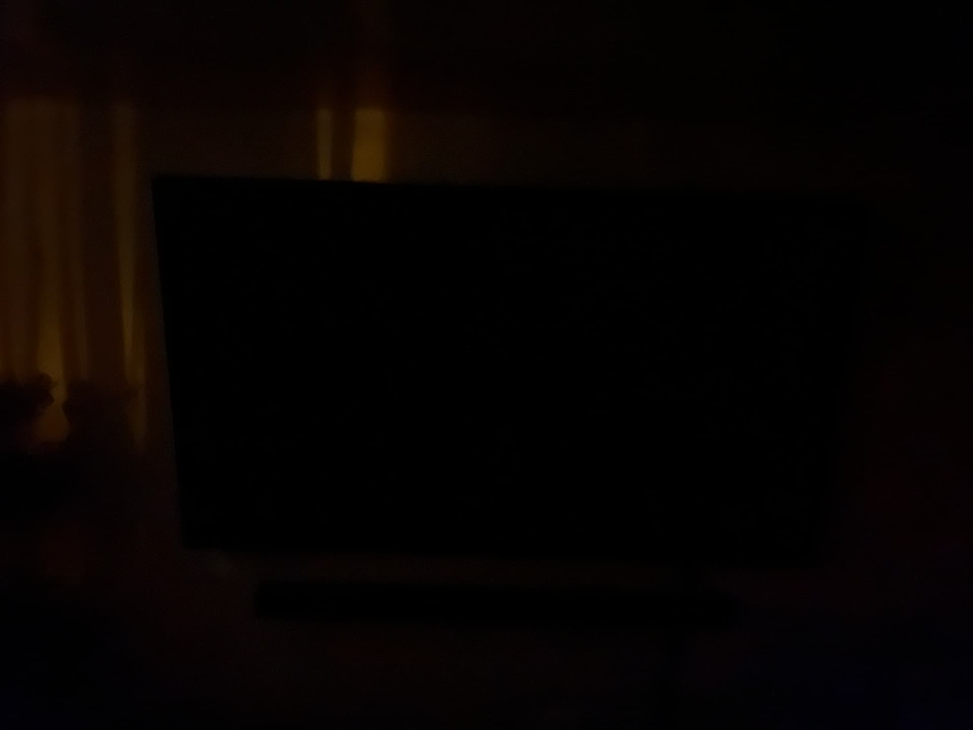

I have an LG OLED55B8PLA and Apple TV 4K and black is not as it supposed to be on oled. For example on movies the up and down black line is lightened…not dark.
If there is a full black transition on the movie…the oled display will remain with light on….not fully dark.
I tested the same movie on infuse (and have this issue) and also on a usb stick and everything looks fine in usb stick.
On Apple TV settings, match content are are both ON.
Check images :slight_smile: 1st image is from Infuse.
Thanks.
And this is how it looks the black image (when paused on same movie…same scene) if played on usb stick.

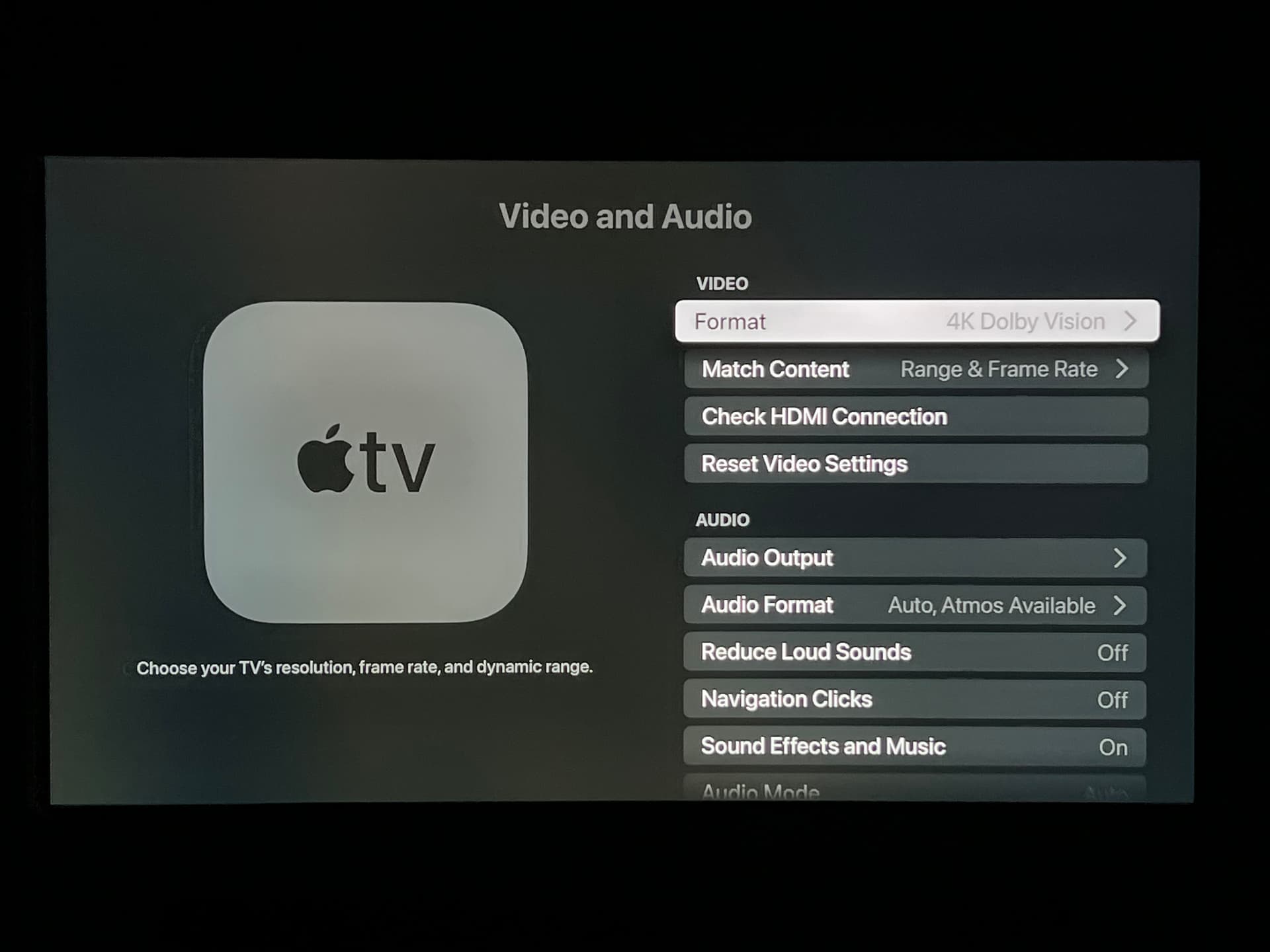

Can you post an image of the Video and Audio settings page from the Apple TV?
In addition to double-checking to confirm confirming the match content options are enabled, you may check the LG’s settings to see if they are set correctly. There is a set of recommended settings on Rtings.com you may consider using.

By default my ATV is set on video format to 4K DV and the background color of the app si pure place. If i change the VIDEO FORMAT on ATV from 4K DV to 4K HDR the the background is washed like in my 2nd post.

Ok…so i found the problem. Somehow some settings were reseted i guess after an update from TV.
The CONTRAST from picture mode was set to 100 (even if i know for sure i set it to 90 when i calibrate it long time ago). So it’s an LG bug…if you set the contrast to 99 for example will have the true black back :slight_smile:
