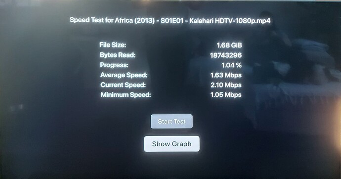

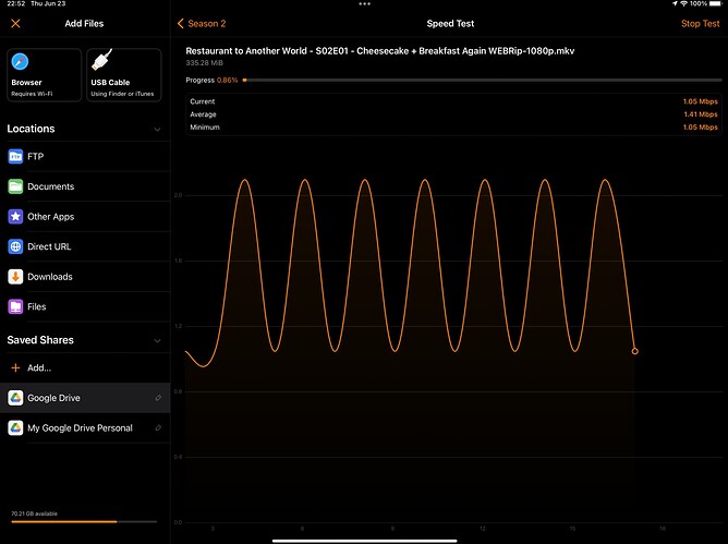

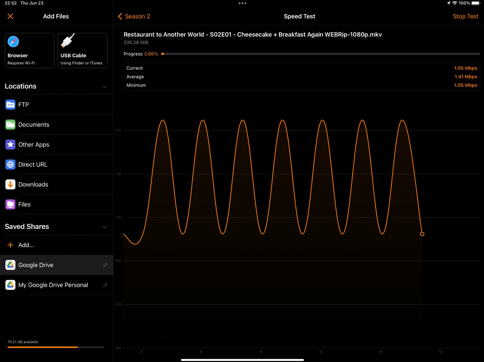

I did some further investigation with speeds tests and this is what I get:
When I’m having the issue speed tests look like this:
Interestingly the rate is identical - averaging out to 1.6mbps

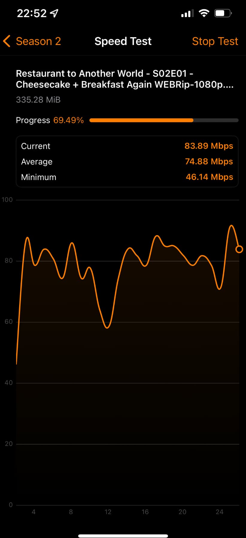

When I’m not having the issue it looks like this:
I’m on 100mbps so that’s about normal for me.

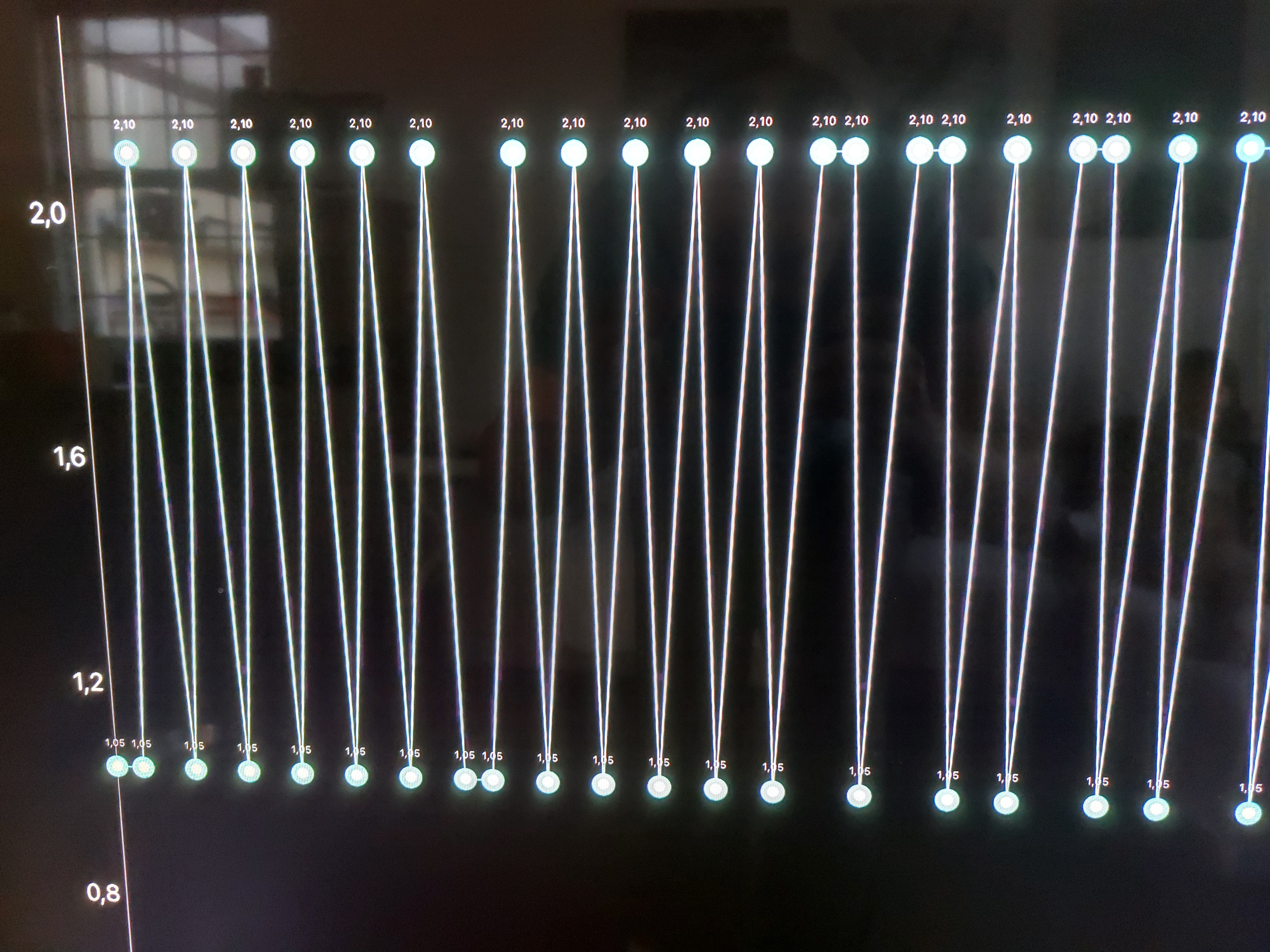

I’m having this same issue. Would often have to restart infuse before it would continue playing the video. But today not even restarting the app works and it will play the first few seconds and then just sit buffering. When I use plex I’m having no issues. I’m using an Apple TV for both plex and infuse
So I also did the speed test and seems I get the same limits
