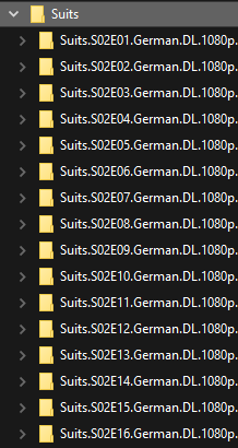

The folder is called “Suits” and inside is a folder “Season 2”. The cover image for Season 2 is correct. But why does the main folder not show a cover image?

Can you provide a screen cap of the file structure? Sometimes if you misspell the name on the main folder it will not pick up the artwork. Also sometimes an extra space or invisible character sneaks in and that too will cause problems with the artwork.
Suits Test File Structure and Names
This test worked great and pulled the series art as well as season.
That’s my structure:
Is each episode in a separate folder also?
Yes, is this a problem?
It may be, just as a test could you bring out maybe 2 or 3 episodes to the season folder level like mine and see if the series poster shows then.
Cool, thank you very much! When I put the video episode files directly to the “Season 2” directory everything is fine :slight_smile:
Perfect!! So I should avoid that subdirectories in the future, right?
