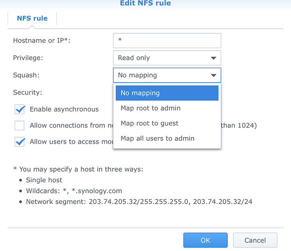

On my Synology, I am able to access files normally with the default Squash value of ‘No Mapping’.
Screenshots here. Best speed between SMB and NFS? - #13 by james

Hmm, based on the other options available I believe ‘No mapping’ means NO_ROOT_SQUASH is disabled. Just for fun, I’ve just tried changing it to ‘Map root to guest’ and was still able to connect.

I’m not sure I agree. My guess is that the Synology settings means:
No mapping = NO_ROOT_SQUASH
Map root to admin = ROOT_SQUASH to admin account/user
Map root to guest = ROOT_SQUASH to guest account/user
Map all users to admin = ALL_SQUASH to admin account/user
But now you also tested “Map root to guest” and that worked for you. This probably means that the guest account must have access to your share, otherwise that would not work. In my case the guest account is denied access to the share for security reasons so that is not option.
