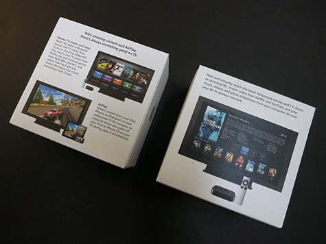

Are you absolutely positive that it is the Apple TV 2 and not the Apple TV 3?
Does the side of the box says 1080P or HDMI?
Or what does your box look like?
Left = Apple TV 3
Right = Apple TV 2
Crap. I don’t know. I didn’t even know ATV3 was out yet. All I’ve read on is ATV2. I will check.
Thanks for the info.
edit: just looked at the model number MD199LL/A, doing a google search shows ATV3.
ARRGH!!
Wonder if I can take it back and find a ATV2?
