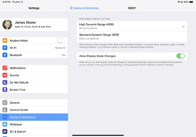

The iPad Pros will support HDR output, though whether this works will depend on the adapter, cable, and monitor you are using.
You can check the capabilities of your attached device via Settings > Display & Brightness > Device Name. (see attached)
