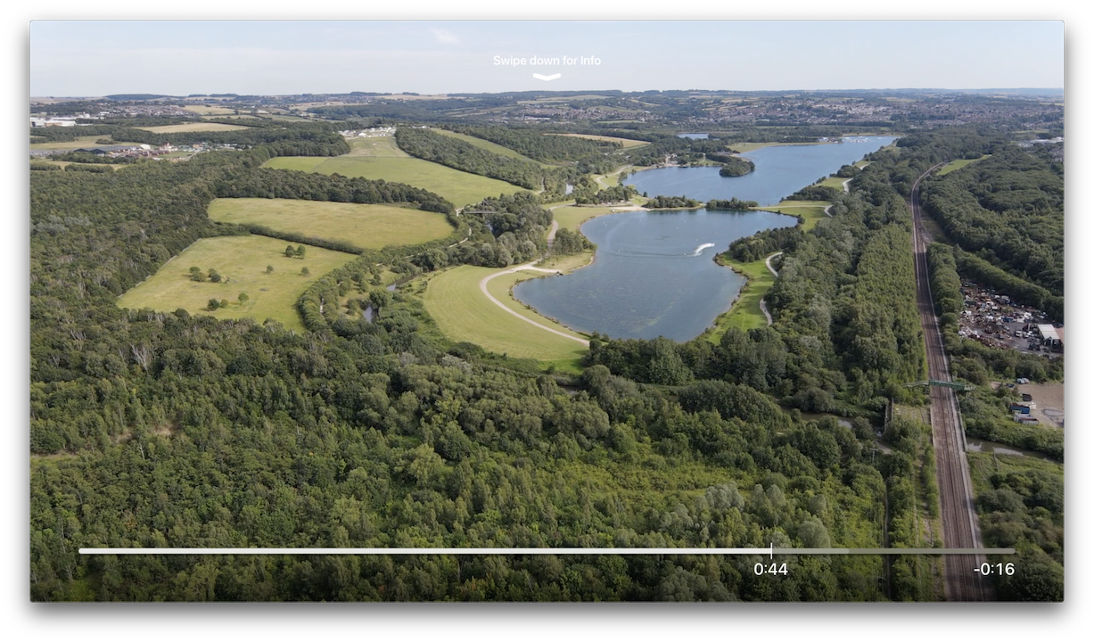

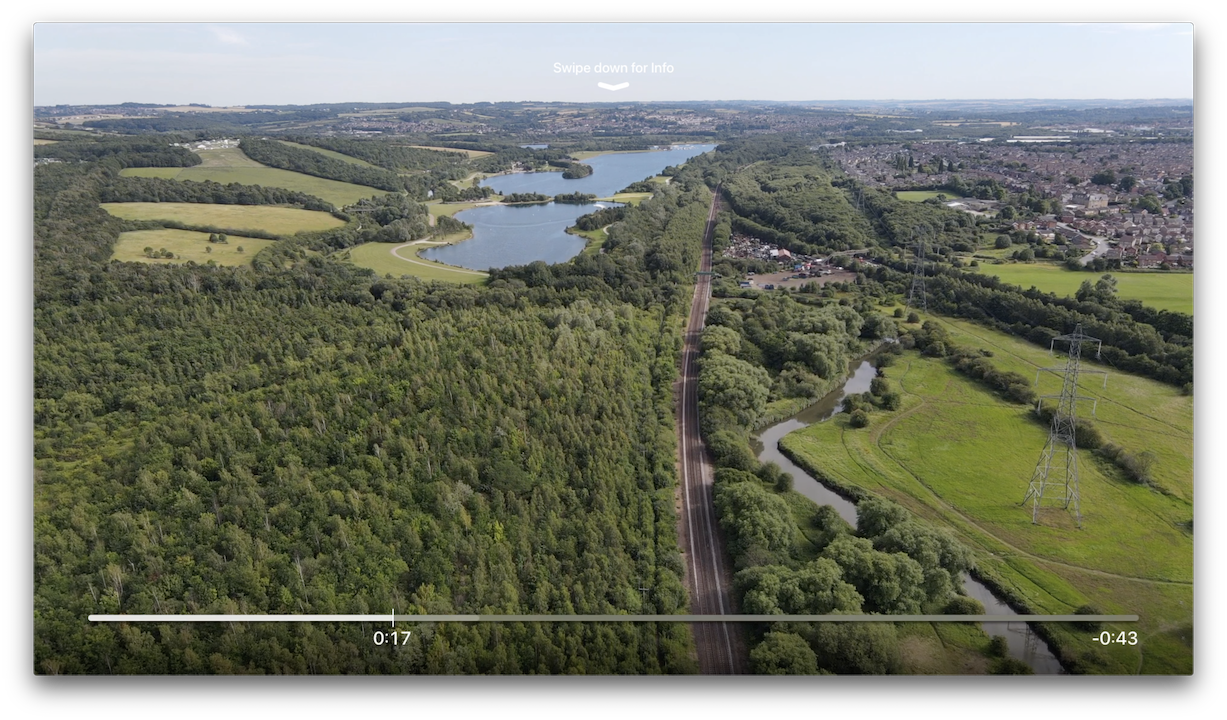

The progress bar in the movie shows Infuse is buffering ahead of the current time at 17 secs in.
And at 44 secs in.
The video played without a problem. No pauses, or buffering wheel.

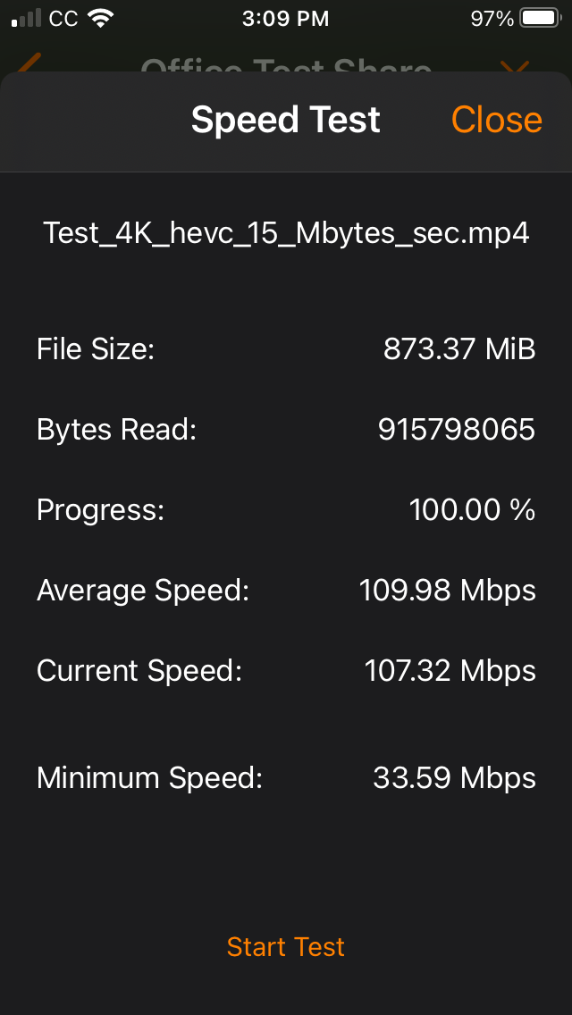

I just found the speed test on the iPhone and maybe the iPad is the same.
Go to the Gear
Select “Add Files”
Scroll to “Saved Shares”
Tap the circle “I” on the share with this video
Scroll down if needed and select “Speed Test”

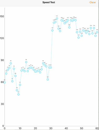

Here’s the Infuse speed test graph for one of my 15 MBytes/sec videos from my iPad Pro:
As you can see, for the first 30 seconds of playback, the data transfer rate is abysmal.
On initiating normal video playback from Infuse (again with a 15 MBytes/sec videos), I get 6 seconds of buffering before playback begins. The video then plays for 7 seconds and then starts buffering again. That’s just 13 seconds total since requesting playback, and the data transfer rate is still far too low at that point as you can see from the Infuse speed test graph. So it’s hardly surprising that the second buffering occurs at that point.
The graph, by the way, is not a one-off. Many tests with both Infuse speed test, and the graphs produced on my NAS indicate that this is now typical behaviour in Infuse.
Also this 30 seconds of low data transfer at the start was introduced in Infuse 6.53 or 6.54. It’s hard to know which, because 6.53 had far more serious issues.
So, I still have 3 outstanding issues that are making the experience with higher bit-rate videos worse than it could potentially be:
  1. Low data transfer rates across WIFI during the first 30 seconds of video playback (introduced in Infuse 6.53/6.54)
  2. Under no circumstances will Infuse transfer data faster than 15 MBytes/sec, even when WIFI bandwidth allows for this. Therefore, the streaming cache will never be able to buffer ahead for these videos.
  3. While buffering ahead, the video transfer is capped at around 8 MBytes/sec (you can see this by pausing the video), and it is indicated in the previous graphs I showed at the start of this thread.

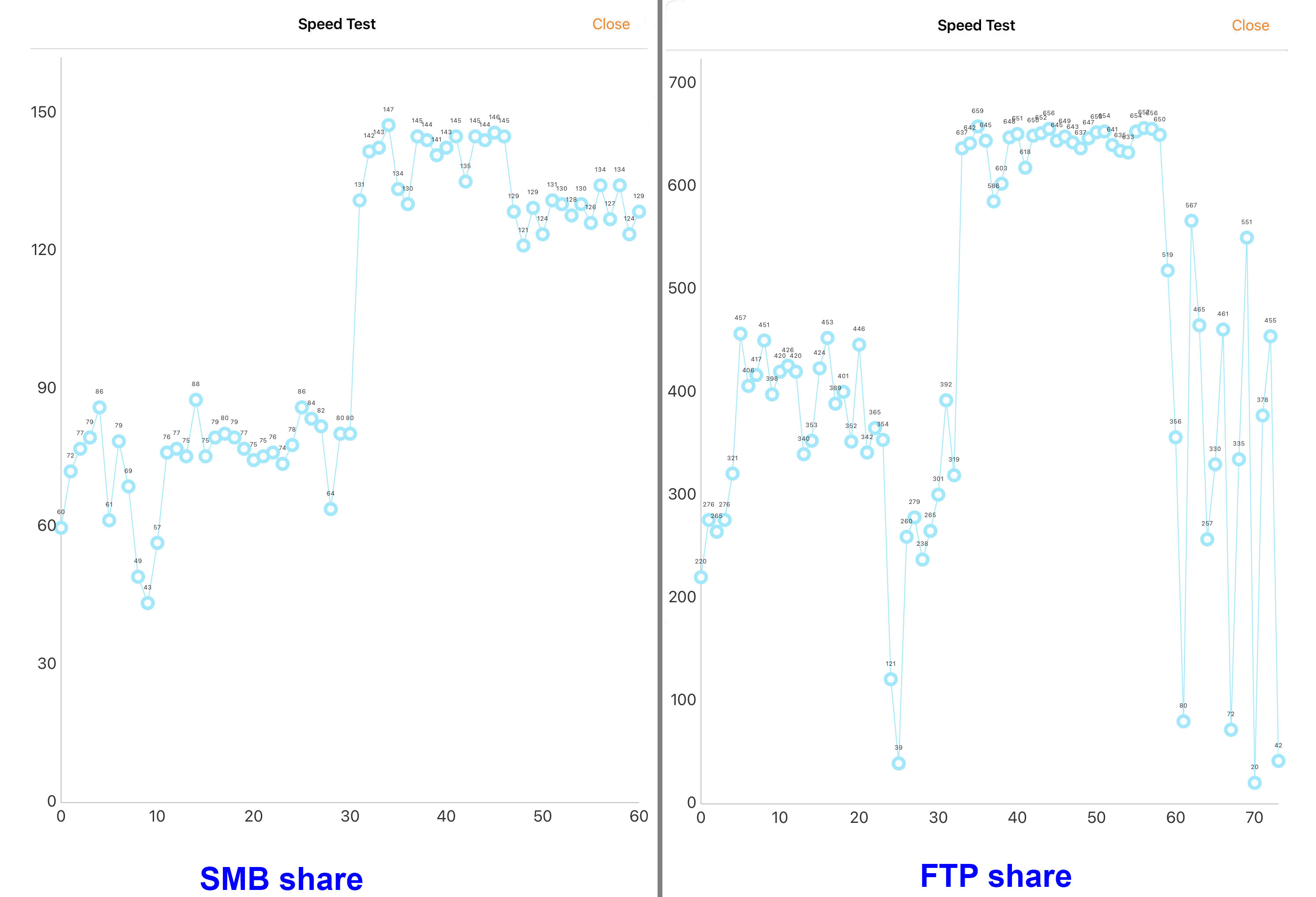

Is there a reason you need to use SMB? Can you try FTP. I’m using FTP because I’ve had similar issues with my android tablet in the past. File transfer speed was very limited. So I switched to FTP and never looked back.
@gggplaya Thanks for the information. There’s no need to use SMB. I’ve always shied away from FTP because it is a very old protocol, and totally insecure. Even the password gets sent as plain-text! However, so long as it’s only being used across a LAN, it’s not quite so bad.
I am very surprised that FTP is so fast… or more accurately, I am surprised SMB is so slow.
At first glance, the results are quite similar, however if you look at the vertical scale the FTP share is much much faster.
There’s still similarities though:
  1. For the first 30 seconds, the data transfer is much slower (issue introduced in Infuse 6.5.3 / 6.5.4)
  2. Even with the increased speed of FTP, the streaming cache still doesn’t buffer ahead when playing back videos normally. For some reason I don’t see the same super-fast speeds during playback that are indicated in the Infuse speed test.
As far as playback is concerned, FTP is giving a much more responsive and stable experience. Playback begins within 3 seconds (7 seconds for SMB), and seeks in the video are much faster, 2-3 seconds (6 seconds for SMB) for my 15 MByte/sec videos.
