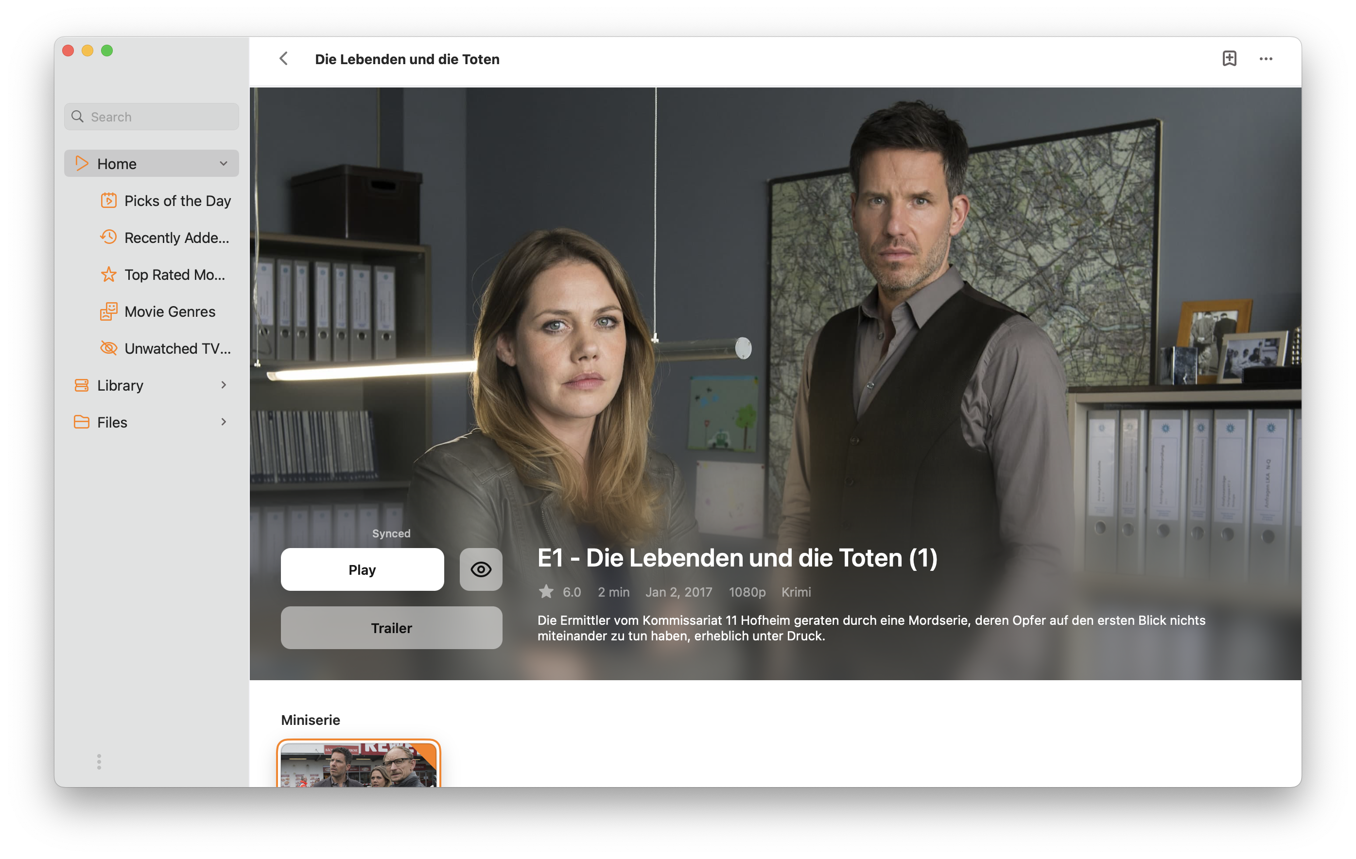

You could create your own metadata and artwork for that file and then it could be displayed as a movie.
If you have just a single file for this title one option is to name it like this.
Die Lebenden und die Toten (2017) S01E01.mkv
This will allow Infuse will to fetch the correct metadata and artwork.
Hi James, this did the trick, thanks, but still this is not a miniseries but a single TV-movie. I guess TMDB is not that accurate…
Well, the IMDB also says it’s a mini series. Often TMDB is more accurate (to a fault sometimes) than TVDB.
