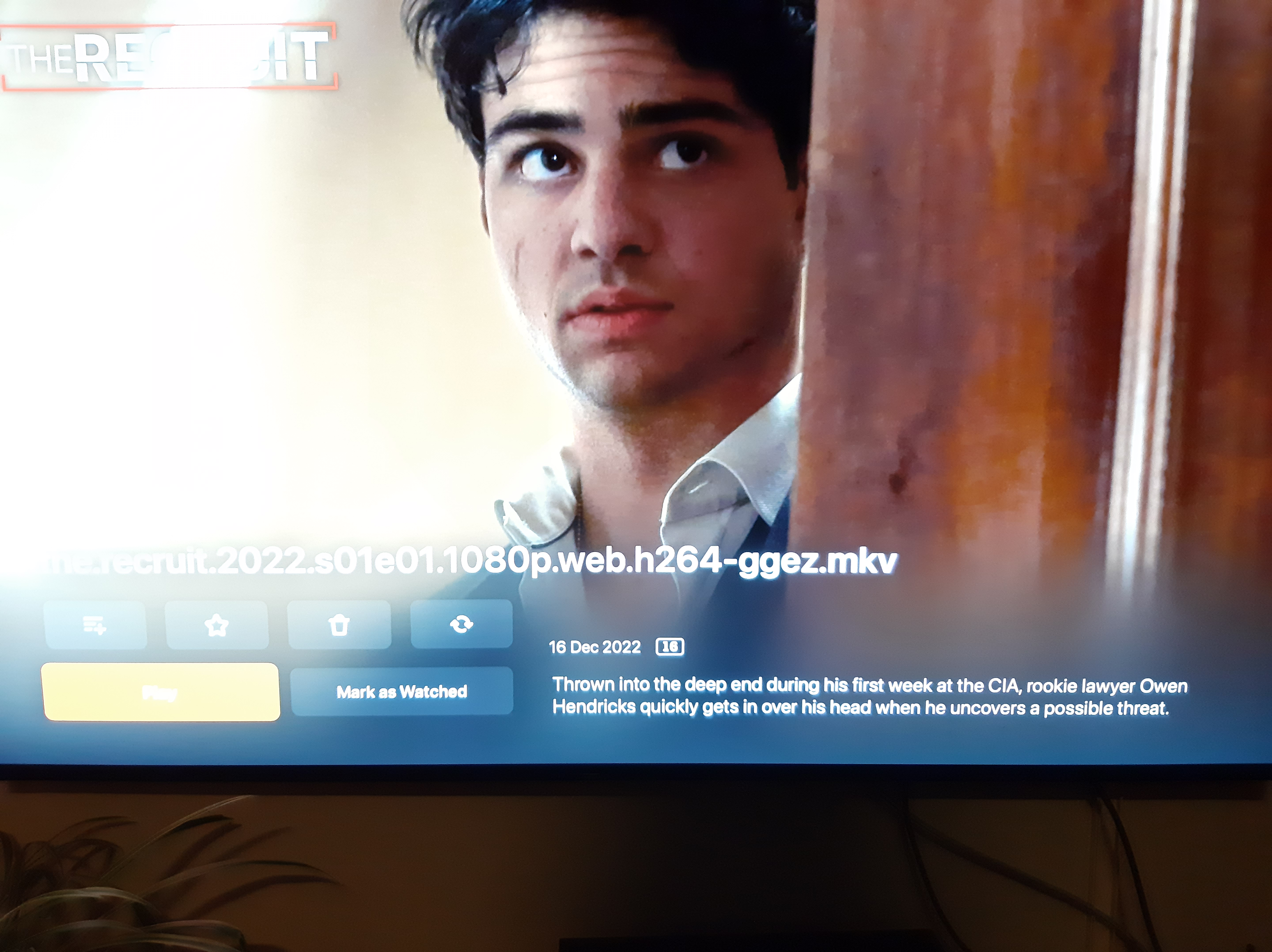

When you say you can’t play these, what happens when you try?
When i try to play the files i see this
I hope you can help mr
Thanks
Frans
Were these files recently moved or changed in some way on your Jellyfin server?
Can you try clicking the Refresh button on the details page to see if this allows them to play?
If the issue persists, please send in a report from your device (and post the code here) so we can look further into this.
