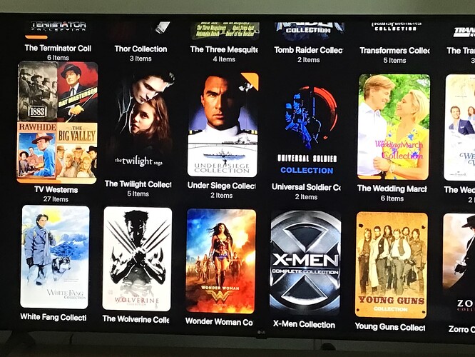

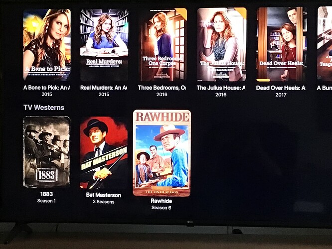

I tried to pin a collection to favourites. First one worked. The second one only shows 3 titles, even though the collection shows more. Took picture to show where collections shows 27 videos in collection. Took picture to show when collection Is opened the titles are there. Then a picture to show when I opened there are only 3 titles.

I’m going to guess about 30 total. That’s the limit for Movies on the home page under recently added and it just got changed from 30 episodes total to 30 TV series on the recently added TV shows so I’m guessing this is a hold over on total items that can be displayed.

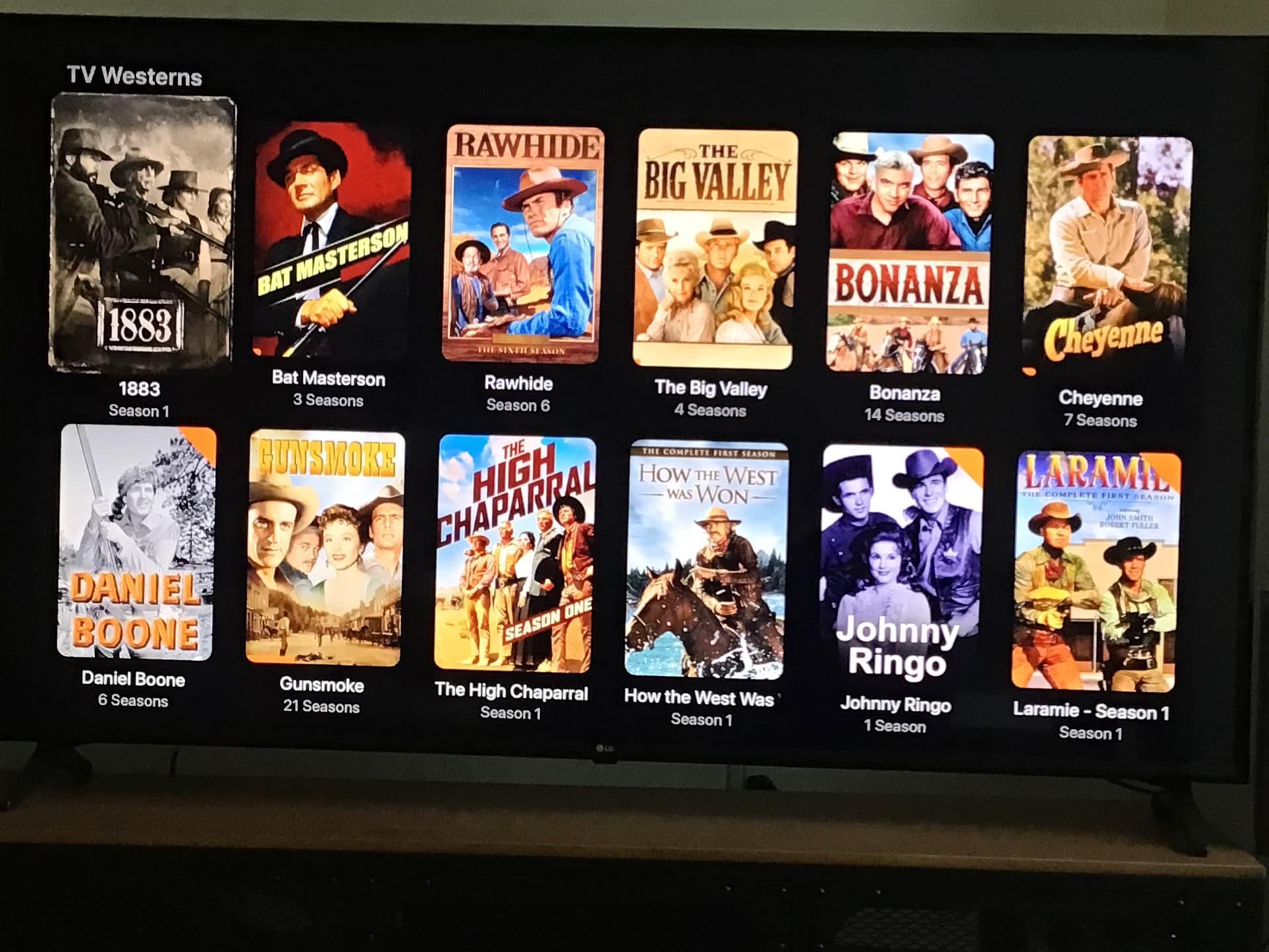

Any way, I noticed in my sample picture that Rawhide says 6 seasons, but I have 8. Started checking all seasons and noticed some were incorrect. I removed the titles with the wrong number of seasons, and guess what, it (collection) works.
So my problem is in the season totals.

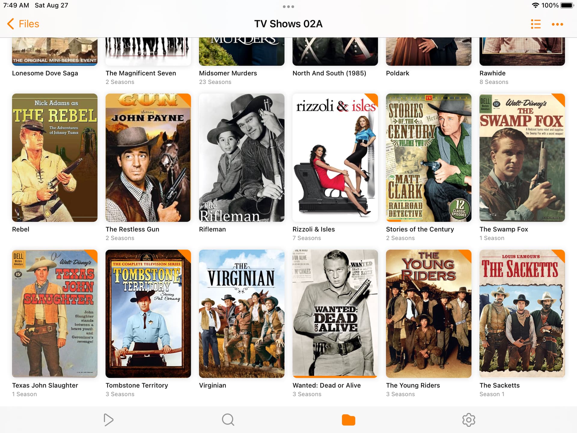

Notice that some of the titles don’t show any seasons. These were causing my issues with the pinning tv western collection to Home Screen.
Noticed that Rawhide ( top right corner) shows 8 seasons while the custom collection showed 6.

I’ve tried removing and recreating favourite folders to see why some folders don’t show the number of seasons of a series.
They show in the default tv folder but some don’t all show in my favourites.
This happens on both the atv4k and iPad infuse.
