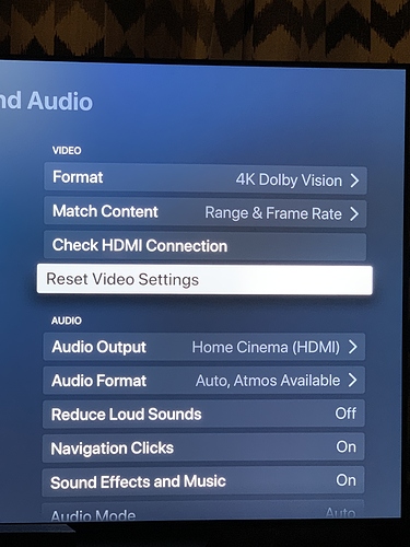

What video settings do you have on the ATV?
Thanks for response.
No, all motion interpolation settings are off. Will try a different cable, but not sure about that because without subtitles there are absolutely no issues.
Here are the settings, but they change according to the video type (e.g. sdr/hdr)

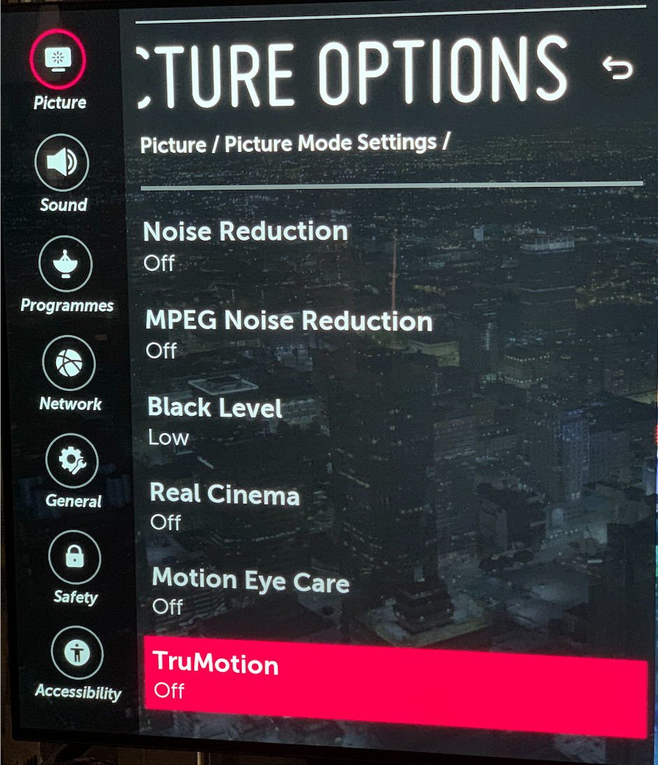

  • Restored my LG B8 to initial settings, turned off motion interpolation completely (TruMotion+RealCinema set to Off), and replaced HDMI cable, but the app still drops frames when some subtitles appear. Tried to film this on my iPhone, but the thing is the frame drops can easily be seen on 55-inch TV screen, but cannot be seen in the filmed video on the screen of an iPhone…
  • One more thing to mention, I don’t seem to have this issue with movies (24p), but deffo had it with 2 last series I watched, both were 25p per media info.
I have no idea what to do next :tired_face:
Motion interpolation settings on my TV:
