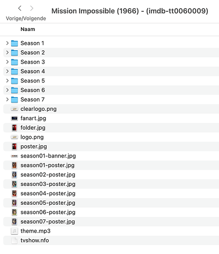

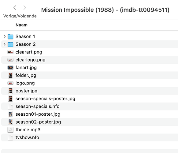

I have 2 Tv-shows…
Mission impossible (1966). and
Mission impossible (1988)
When I set the 1966 as metadata online, it shows the correct one and correct posters for all seasons.
When I set the 1988 as metadata online, it shows correct, BUT. when I go back to the 1966 it shows the posters for season 1 and 2 the seasons posters from the 1988 version.
And Vice versa…
When I set one of them to local metadata, it will not show any season at all and it will not show up in the library.
I am beginning to get madder every time is start using Infuse.
Why so many of these weird problems.
And yes before one says (have you named your artwork properly)
YES. I am using Tinymediamanager, which is the best out there. So, its an Infuse issue, nothing else!!

Can you provide a few examples of how you have these files organized and named?
As long as Infuse is able to distinguish between the files for series a and series b it can easily handle having multiple series with the same name.
Here’s what I’m seeing here with files named like this.
Mission Impossible 1966 S01 E01.mp4
Mission Impossible 1966 S01 E02.mp4
Etc…
Mission Impossible 1988 S01 E01.mp4
Mission Impossible 1988 S01 E02.mp4
Etc…
See images
All this naming was Done with the app INFUSE advised to use for naming.
TINYMEDIAMANAGER.
tv-show.nfo has also all the correct info in it… including the year.
Adding the year to the episode filenames (for at least one version) should resolve this for you.
You mean all files in all season folders?
Cuz the main folder has year and imdb
I’ll try at the 1988 version
Correct, like in the example I posted above.
You wouldn’t need to do both 1966 and 1988, but just one of them.
Looks like that did the job, but I had to rename both shows with the year in its file name…
I 1st did only the 1988 version, it looked that worked, but then in the 1966 version, season 1 and 2 had the poster of the 1988 version.
So i renamed both and that did the job.
