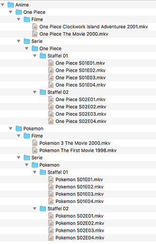

Here is my share with all folder (some containing movie(s), some serie(s) and some movie(s) AND serie(s):

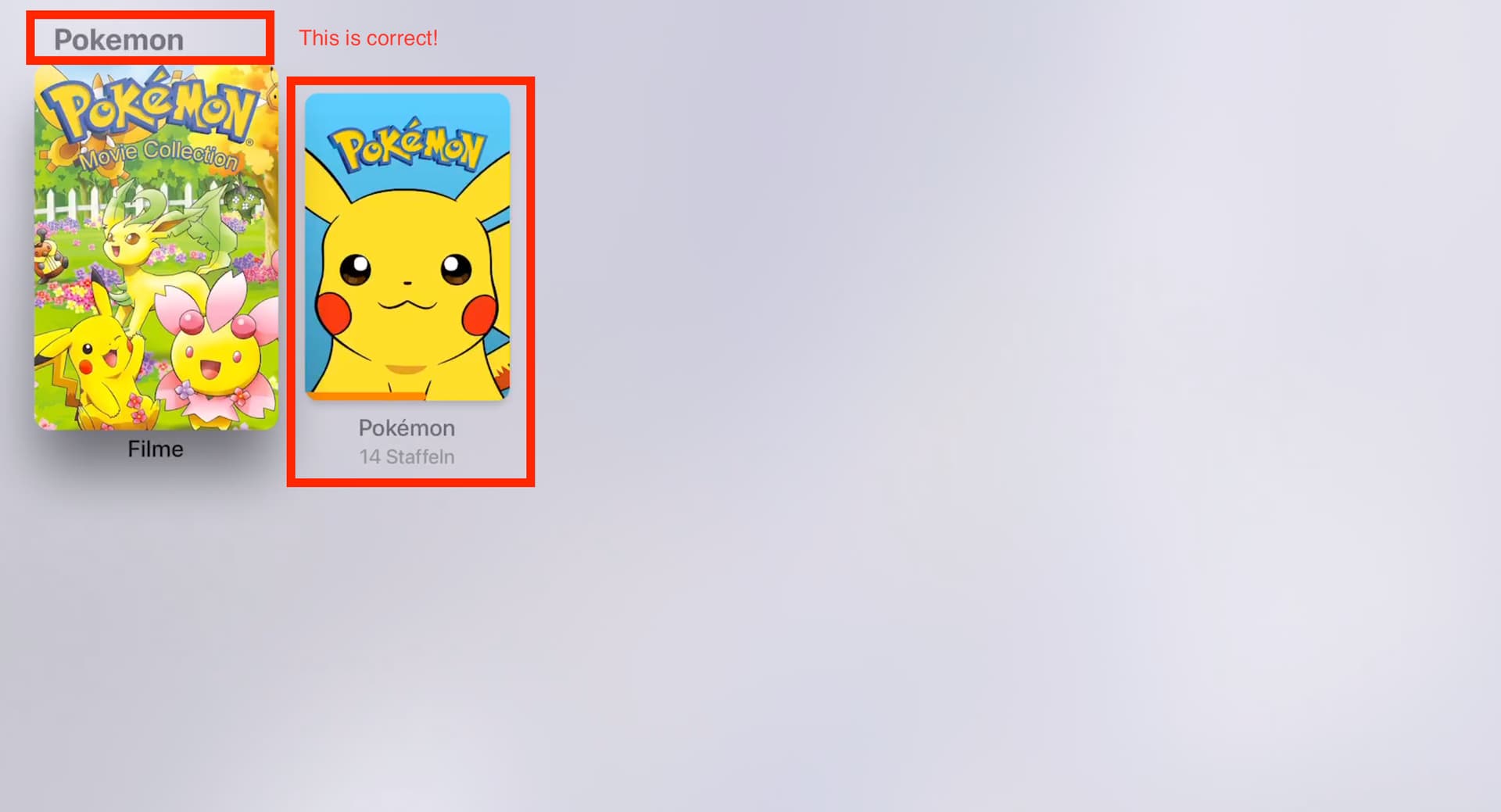

Now when I go into my Pokemon folder, which contains two subfolders (movies and series), the series is shown correctly as Pokemon:
Now when I go into my One Piece folder, which ALSO contains two sub folders (movies and series), the series is shown wrongly:
When I change the metadata then to One Piece, Pokemon is changed to One Piece.

Can you provide examples of how the files that are changing are named? Is it specific series or all of them? Maybe a screen cap of the file structure and how their named would help figure out what’s going on.
If you’re not including the series name in the actual filename (instead relying on parent folder naming) Infuse will try and fetch the correct info from one of these folders. It looks like something in your mixed organization structure is breaking this.
Adding the series name to the filename is probably the easiest solution here.

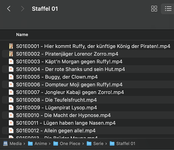

The files are in this format “SxxExx - Episodetitle”:
Pokemon:
One Piece:
Again both are only examples. Others are also affected, but only the ones that are in a folder together with movies.
Single series folders (without movies in them) seem not to be affected.
