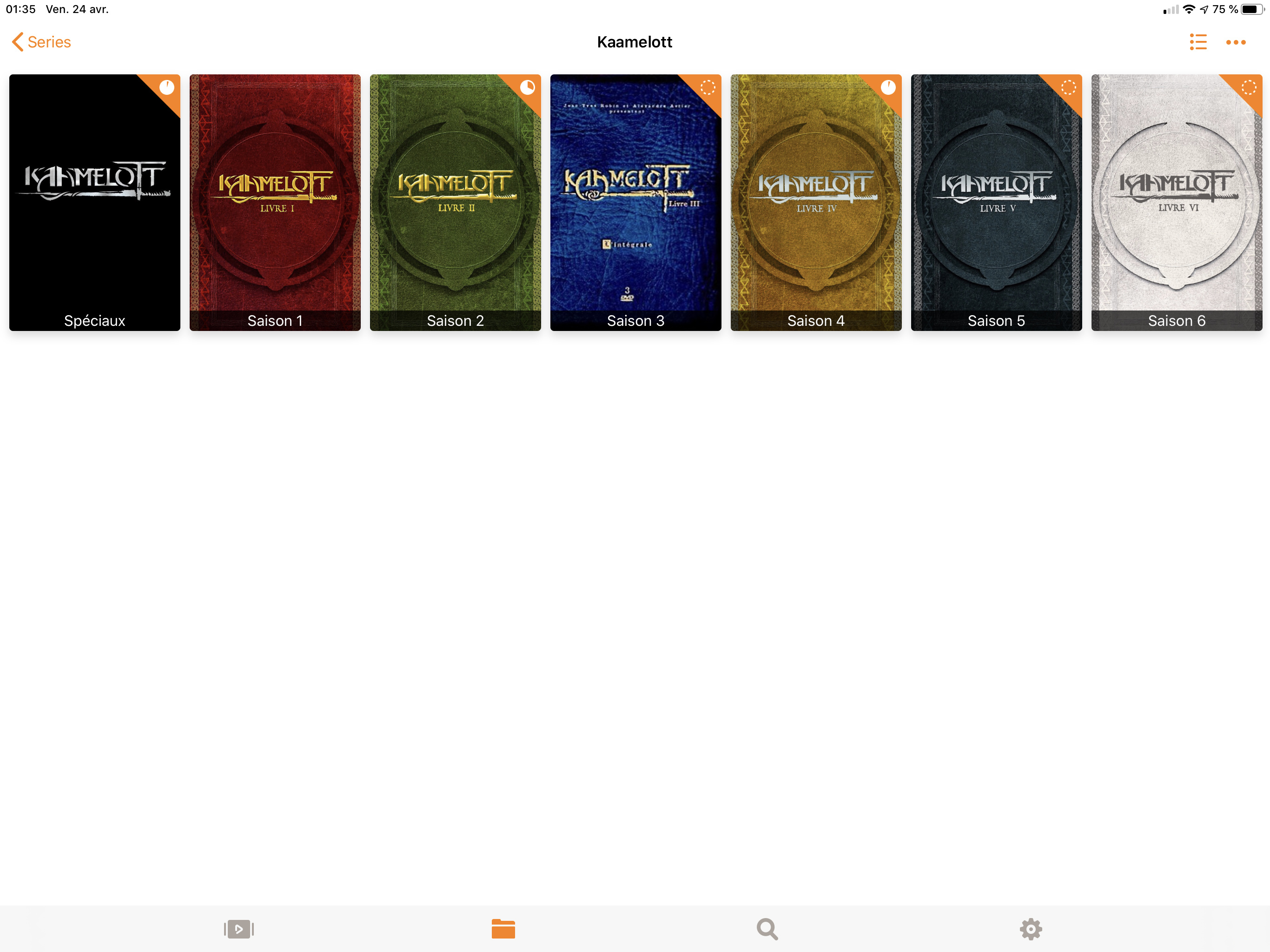

i join a photo of how it look on infuse.
only one poster is present for season3 and it come from tvdb, others are not refresh

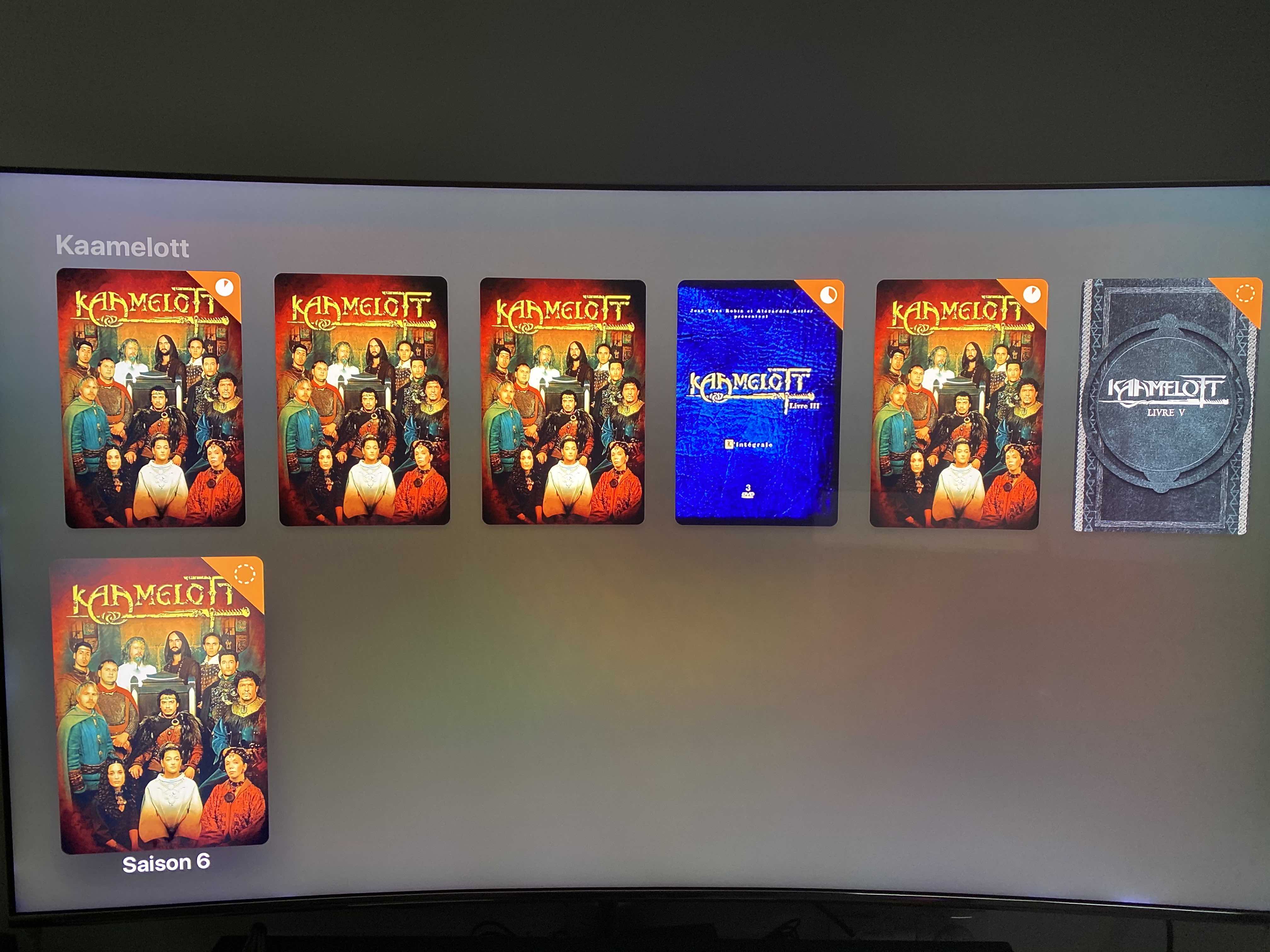

I tried this morning on MrMc on appleTV . I join the photo of what I get from thetvdb , all is good.

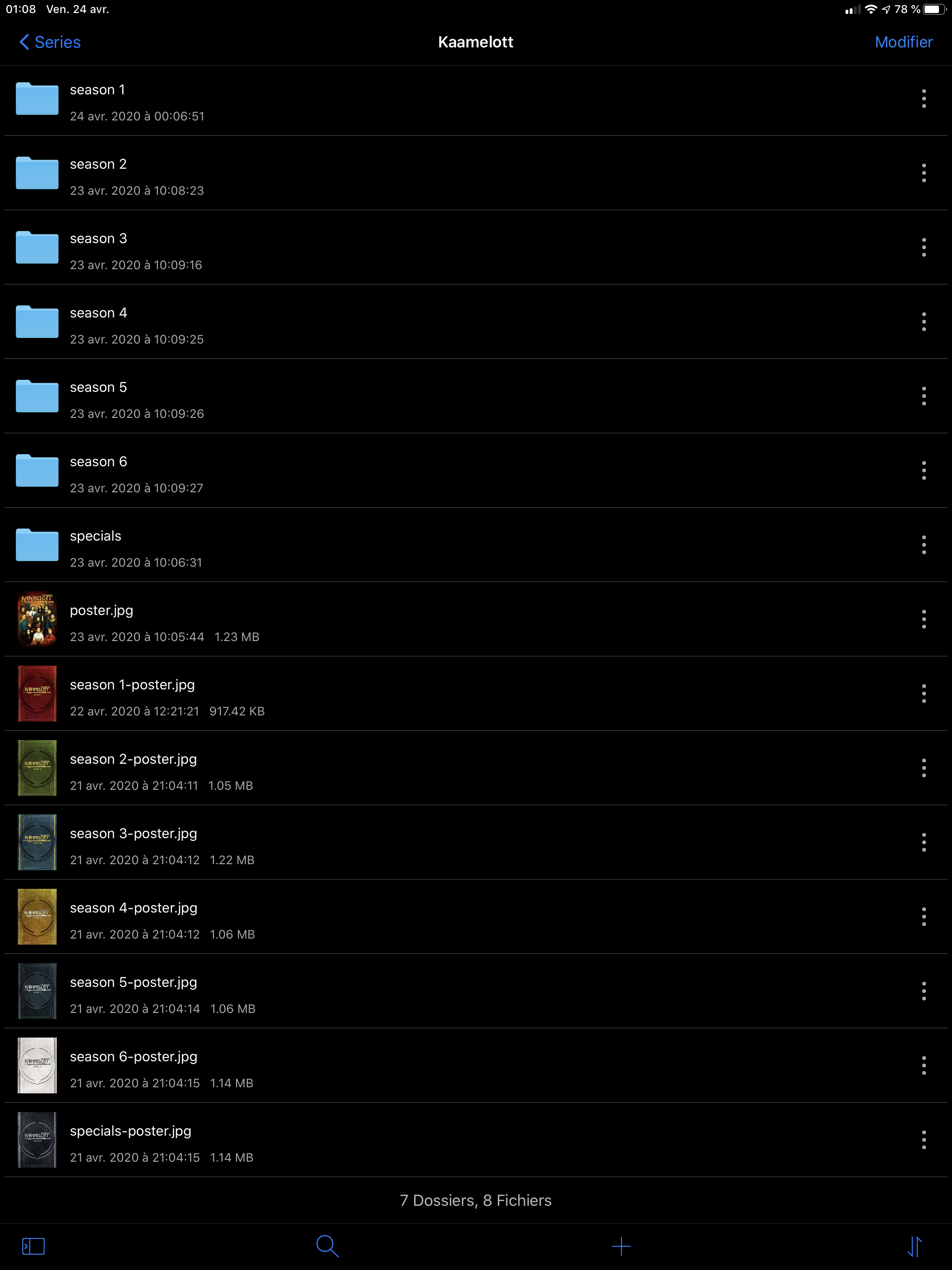

Can you post a screenshot of the folder structure showing how you have these images named/organized?
Also, if the images were added after Infuse scanned these shows, you will need to use the Edit option on one of the episodes, reselect the correct series name, and the metadata/artwork will be updated.
I joined a screenshot of the folder structure

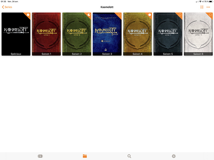

Since I uploaded some new poster to the tvdb it’s a little better, but season 3 is still using English poster,infuse metadata is set to auto same thing appear if I set it to French ( infuse is in French)
None of season poster are override by posters jpg on folders .
I never was able to have a good poster specials

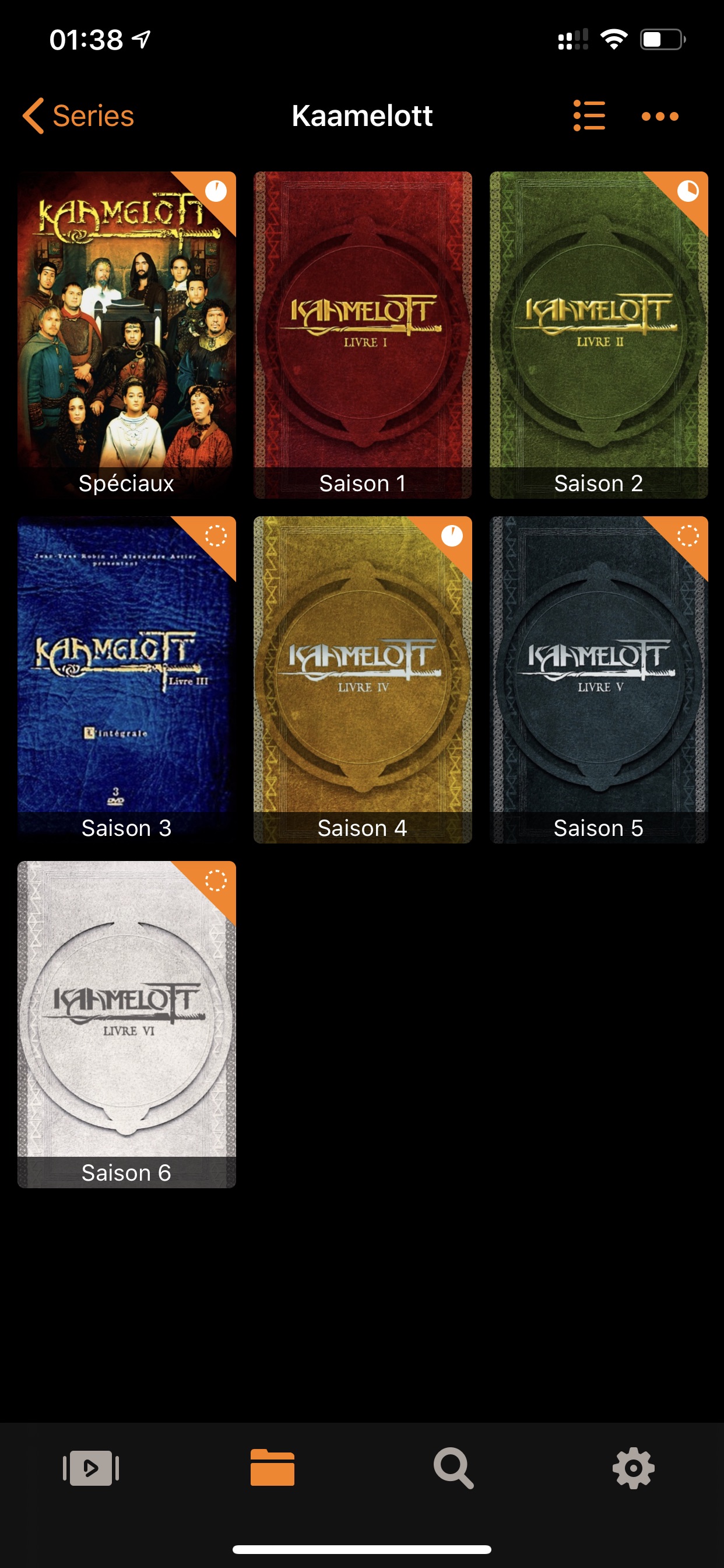

Series poster is different on iPhone ( it’s the good one). As there is no poster for specials series poster is used.
If I sync metadata with my iphone I can have good series poster with infuse iCloud sync
Actually I’m not far from the goal . Specials poster is missing and season 3 is not the good one

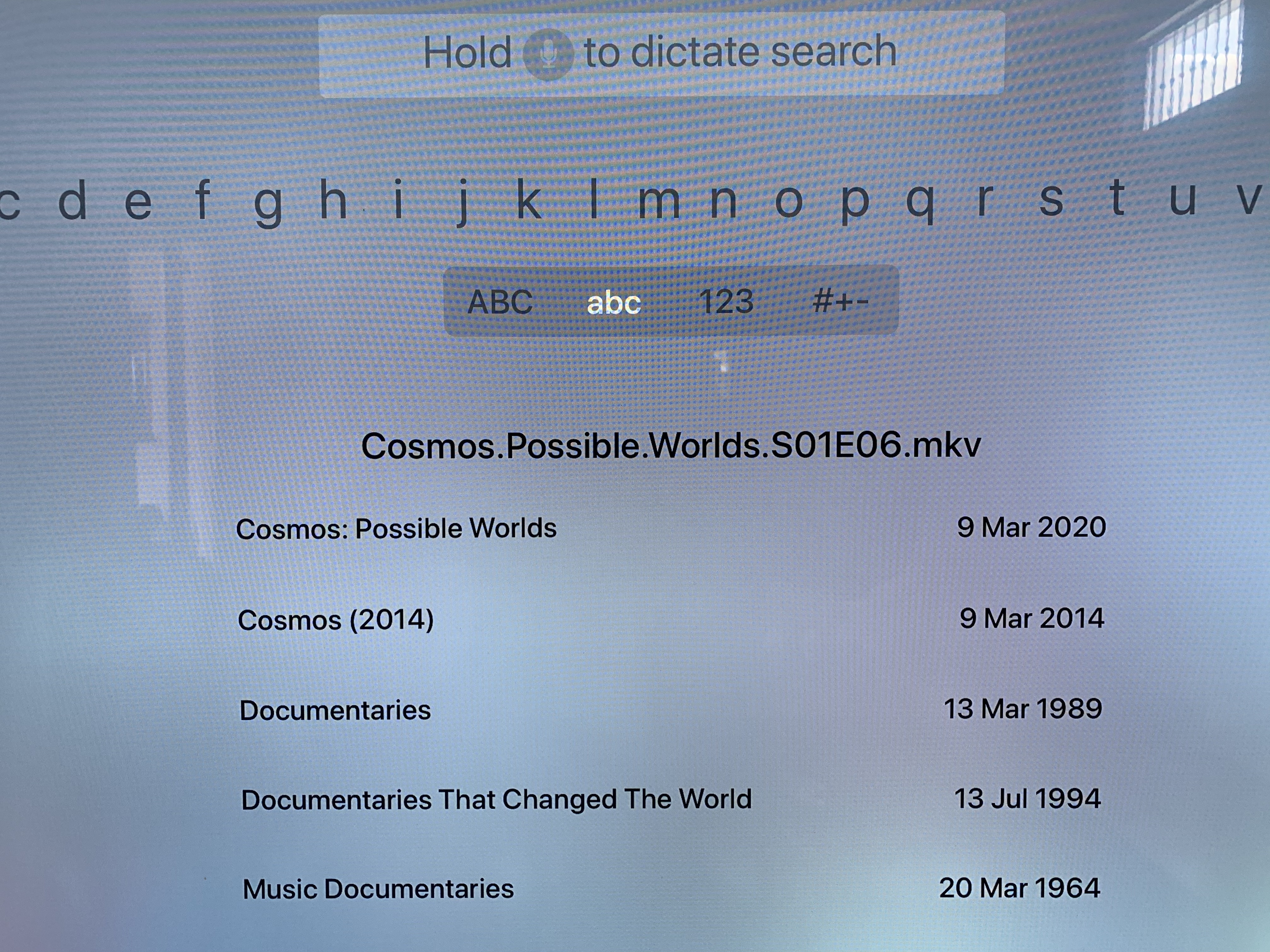

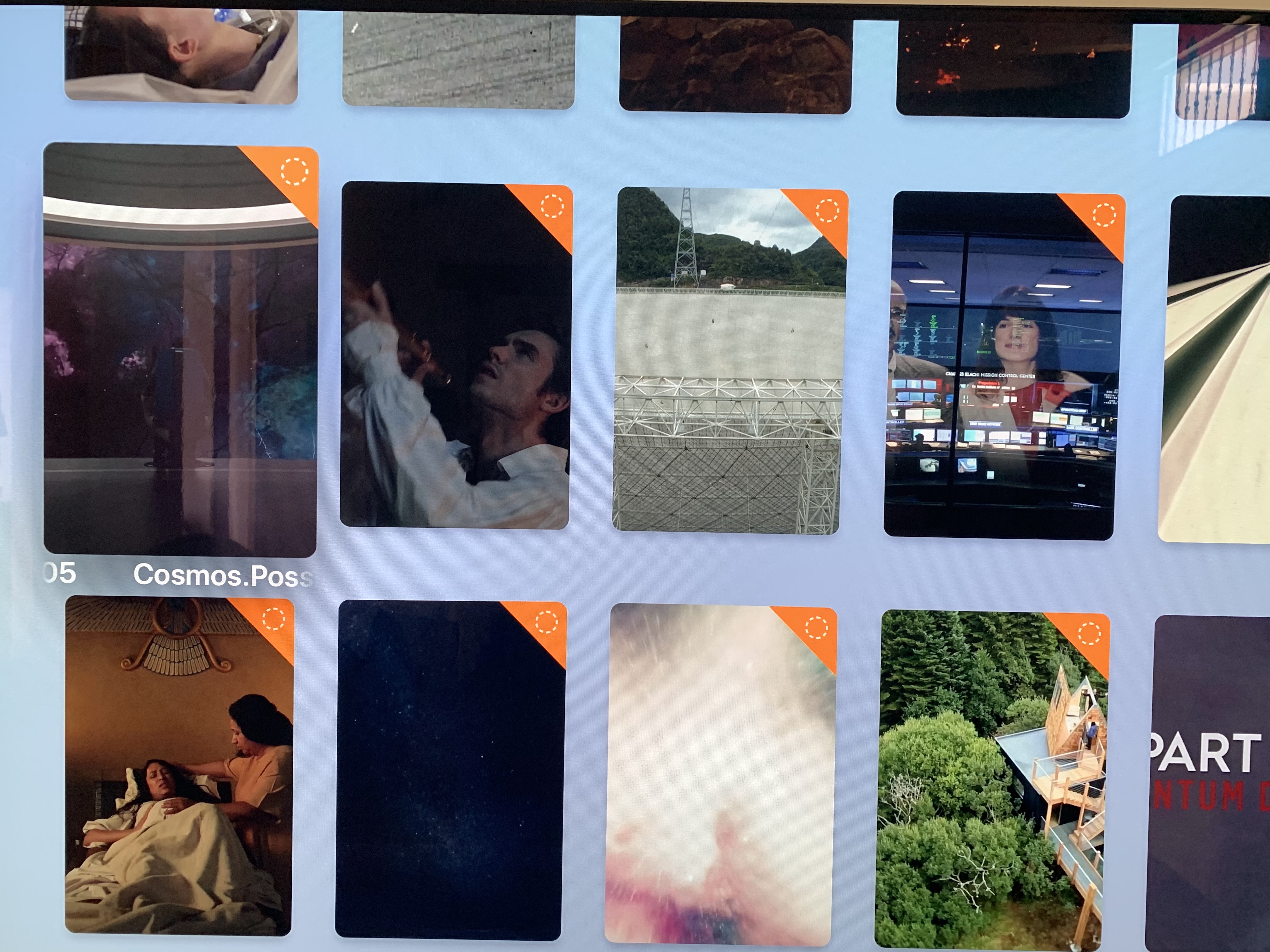

Hello,

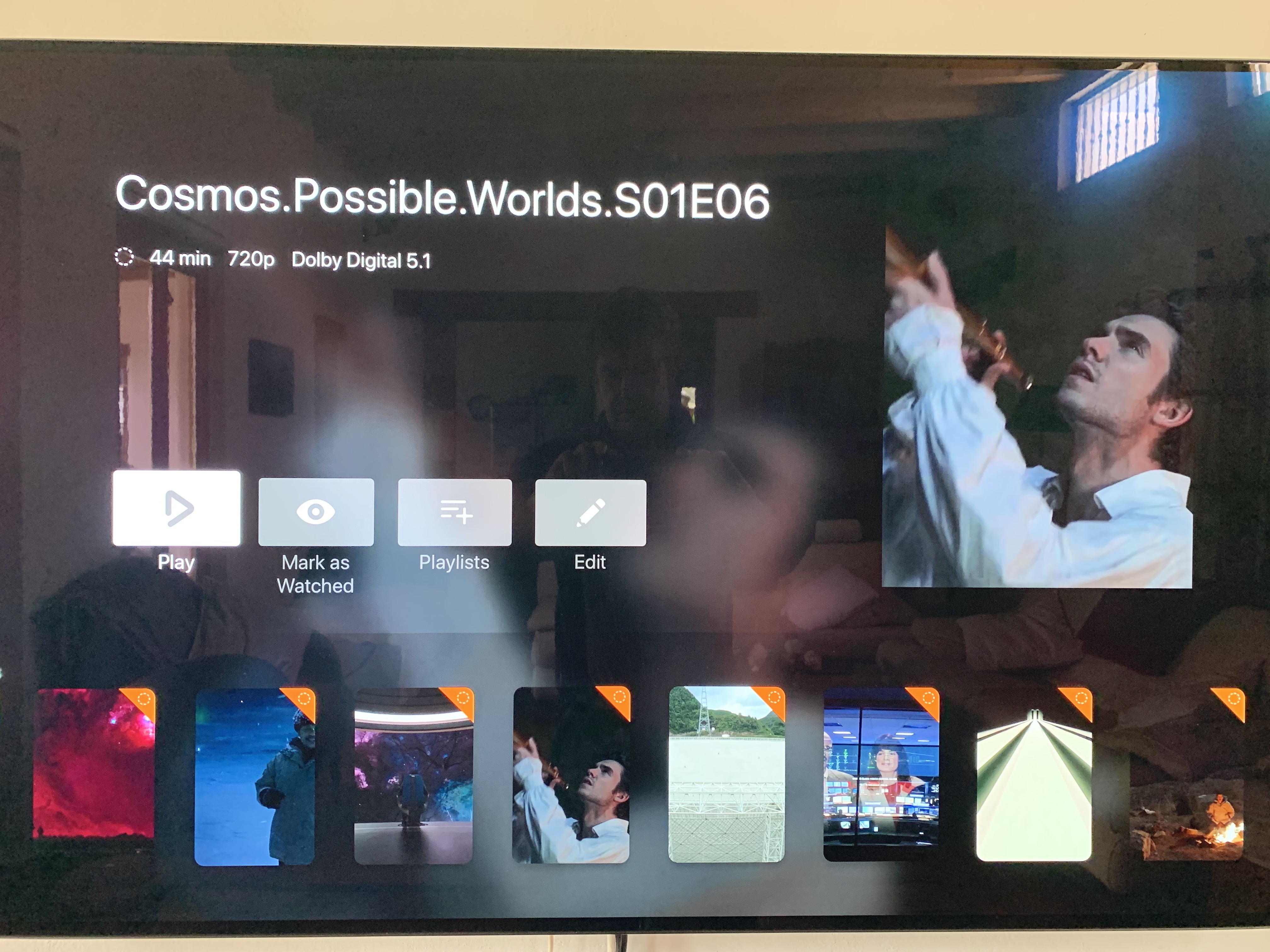

I have recently noticed a similar problem, I have added series called Cosmos.Possible.Worlds to my hard drive. The files are named Cosmos.Possible.Worlds.S01E02 etc.
Infuse on my Apple. TV4k does not find the metadata and displays the files as 12 files. When I use the. manual edit. to fix this the title of the documentary comes up in the list but has no change on the files. Normally they move into one, with the correct metadata. Infuse Pro 6.3.5 (3026),
Many other series added in the past are displaying correctly.
Thank you.
Edit.I found that this subject has been answered in March.
Rename the files S02E01 etc and in edit metadata point at Cosmos 2014.
