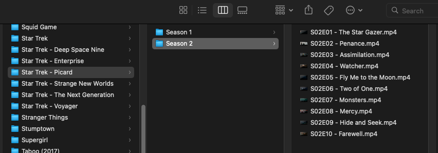

How do you name your folders and files? I have mine named and ordered as follows and I have no problems.
As @Frankje said, names and folder structure are usually the problem.
If you provide an example of how you have each series episode files labeled we can help get it worked out.
Don’t turn on local for anything you don’t want to provide local metadata for.
For Star Trek Picard you’ll want to name your files like this.
“Star Trek Picard S0xE0x.mkv” where the “S0x” is the season number and the “E0x” is the episode number.
I prefer the file names to have the series name AND season with episode. This makes searching far easier on the server and also for me has been more accurate in getting the metadata.
Here’s the users guide for structure and how to name files.
