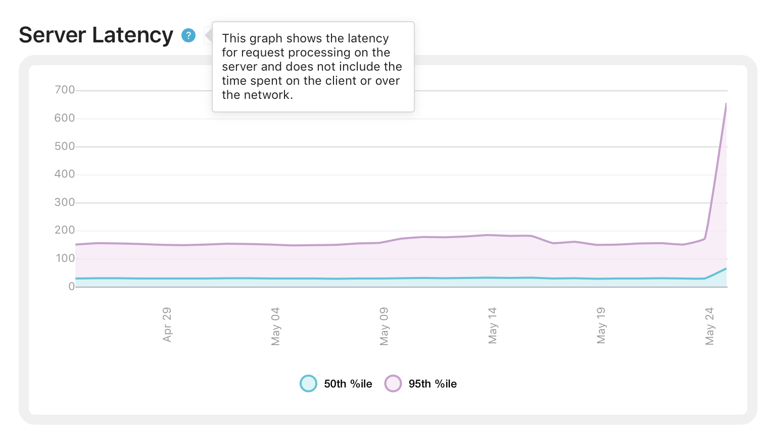

What happened and why?
What to do if you are affected

Update (5/25)
Things appear to be getting back to normal
Update (5/26)
We received confirmation from Apple that they are investigating what happened here. More updates to come.
Update (5/29)
We are working towards a 2-part plan to help prevent issues like this from occurring in the future. The first part is a short term solution that will simply display a popup prompt if Infuse notices a lot of data from iCloud has been removed. This will provide an opportunity to sync these changes, or disable iCloud sync to ensure the data on your device is unaffected. Phase 2 is a little more involved, and will allow Infuse to effectively sign all changes made in iCloud. Once this is implemented, only changes that have been signed by Infuse will be synced to other devices, and any change (including removed and/or missing data) that is not signed would simply be ignored.
Also, we received confirmation from Apple today that the issue has been escalated to their engineering team.

Update (5/31)
We’re getting some reports that the original data is starting to appear back on some affected devices which seems to indicate the issue was only temporary. We’re continuing to monitor the situation, and plan to have the first round of safeguards available in Infuse 5.7.3 which we hope to submit to Apple next week.
Update (6/4)
We received confirmation from Apple today that the issue has been resolved. :smiley:

Now I’m curious as to if there was a glitch with icloud that told everyone they didn’t have any share and if that happened then the metadata would disappear since there were no shares with files to have any metadata.

I think this is just a random server issue happening. Maybe iCloud, maybe infuse, or both? Have had iCloud Sync on with no problems for years.
