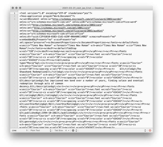

File attached.
2001-03-31_visit_jas_0.txt (7.27 KB)
Did you use Word to open this file at some point? There is a bunch of extra formatting (see attached) which is likely causing issues with Infuse.
I’d recommend downloading the free version of TextMate (https://macromates.com) for editing XML files like these.
