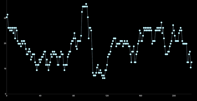

Could you do a speed test in Infuse for one of the problem files and post the results and a screen cap of the graph here?
Here is a test:
File size: 18 GiB
Progression: 2.63%
Average speed: 18,94 Mbps
Minimale speed: 6.29 Mbps
And the graph:
