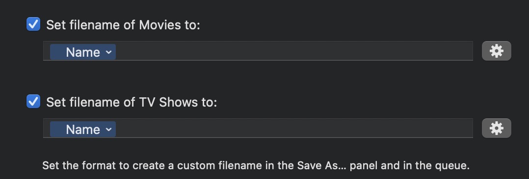

I used Subler to embed the metadata and it lets me specify how to name the files, so I’ve been naming them, e.g. (tv), Show Name S##E## Episode Title.filetype. That’s according to how Subler fills the “Name” field of the metadata.
