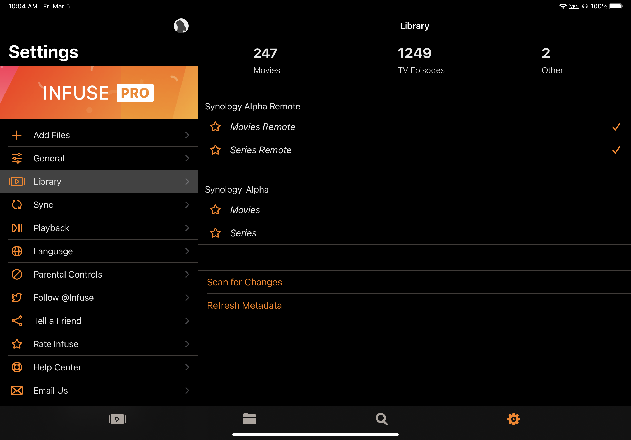

I’ve been using Infuse on iPhone/iPad/ATV for years locally, however I’ve recently tried to set it up for streaming remotely from my Synology NAS and was successful in adding the library through WebDAV. I’m trying to set up my devices such that iPhone/iPad use the remote shared version of the library, while my ATV uses the local share version for faster streaming locally. To do this, I added both version of the same shares (local and remote) but only star the appropriate source on each device.
However, since I’ve done that, my TV shows episodes appear doubled when opening a show through the Watching, Recently Added, or Unwatched lists; when I open a show through TV shows, it shows only the episode from the share i want on each device appropriately. This doesn’t seem to be a problem with my movies which are set up the same way.

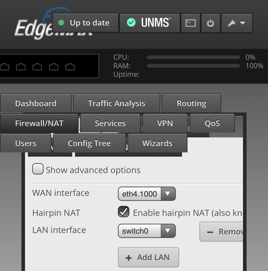

I’ve attached a photo of what the NAT option looks like on my router. It might also be called Nat loop back or reflection.

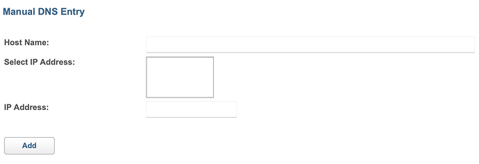

However, I do have an option for manual DNS entry but it just lists my NAS and its local IP address:
Do I add something else here?

Are you able to type in a manual dns entry and select your NAS as the IP? You’d want to type in your dynamic dns name as the host name.

I tried adding the NAS with the DDNS name and my local address to the NAS but it didn’t change the speeds or anything. My NAS is a Synology DS220+ which I have Docker containers running on for different services, but I wouldn’t know the first thing in move the DNS off from my router to it… My router is one that was provided by my ISP, I guess I could look into getting one with NAT pinning. Alternatively, I guess I could make the entire library go through Plex and add my entire library/share in infuse that way, but I thought that might be more resource intensive?
Plex might be your easiest route. You can test to see if your static dns entry is working by doing a NS lookup while connected to your local network. An ba lookup of your dynamic dns name should send back the IP of your NAS vs your wan IP.
