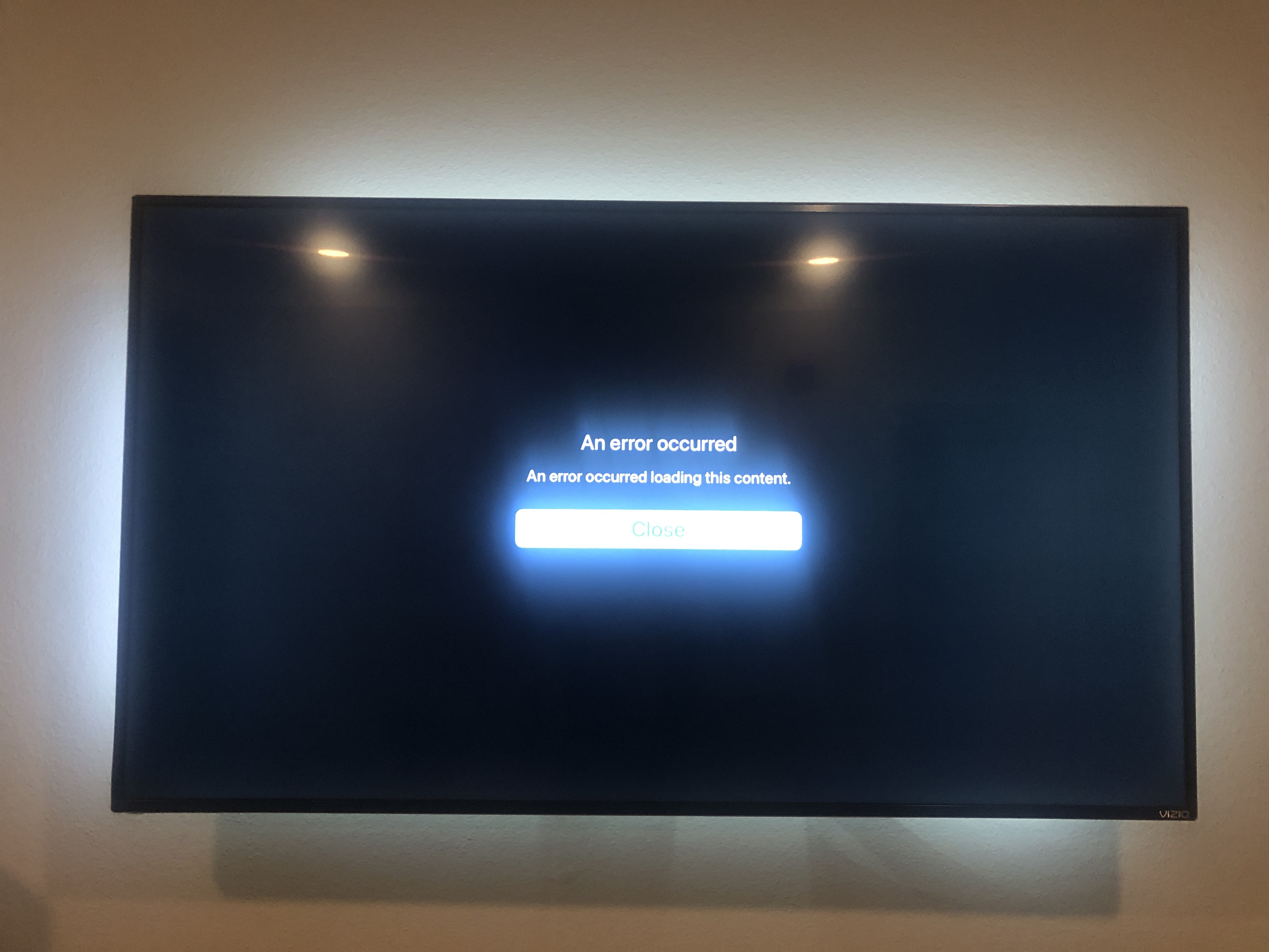

Just signed up again for Pro, cant get anything to play

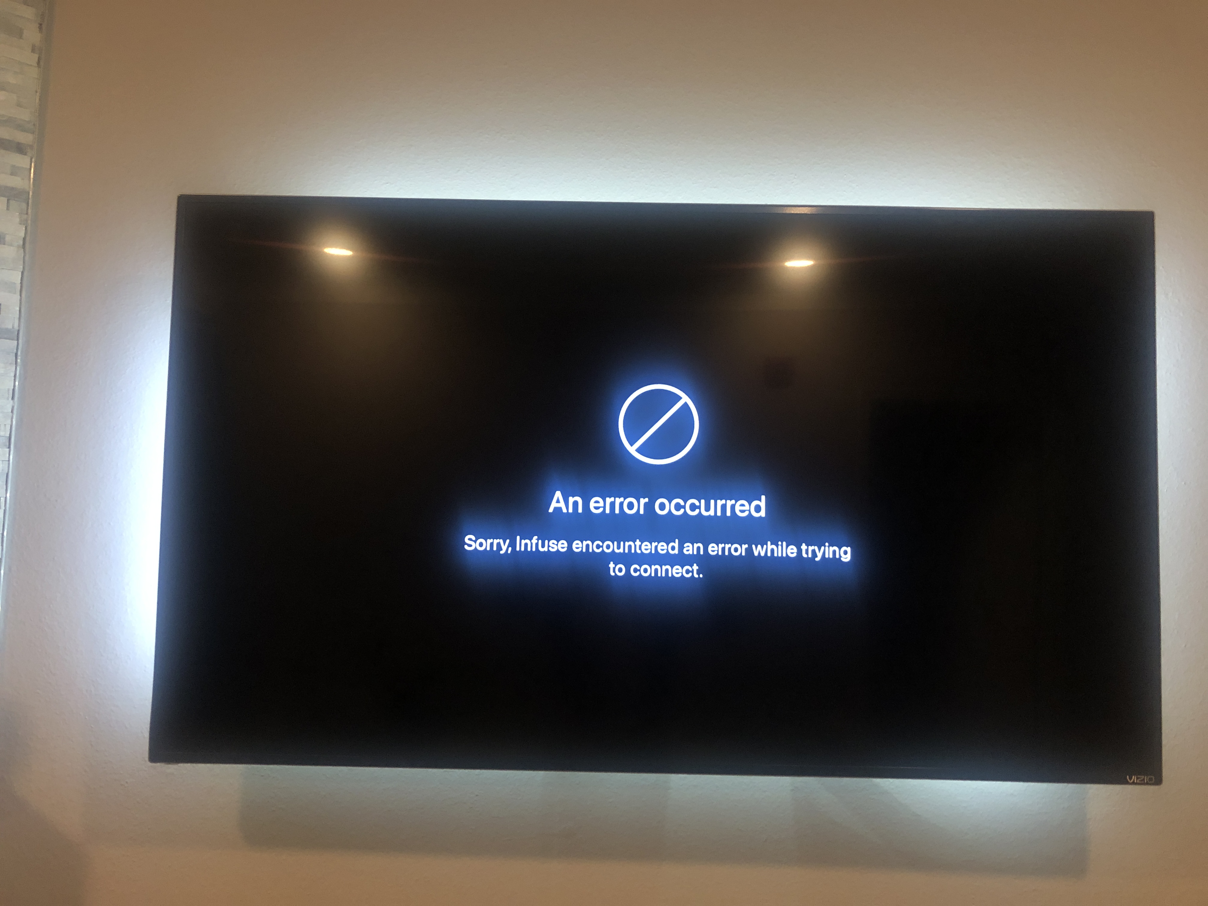

I got fed up with the plex audio sync issues, so I signed up for infuse Pro again on my apple TV. i am accessing from my inside my home, I’m not even remote.

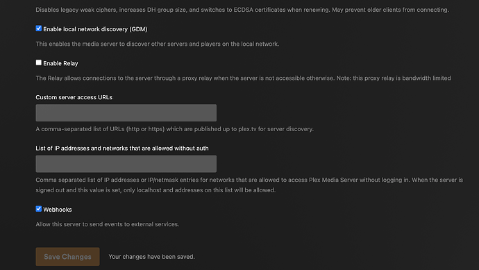

With relay turned off, I can’t even get to my plex files.
With relay turned on, I can get to my files, but get an error saying relay is active.

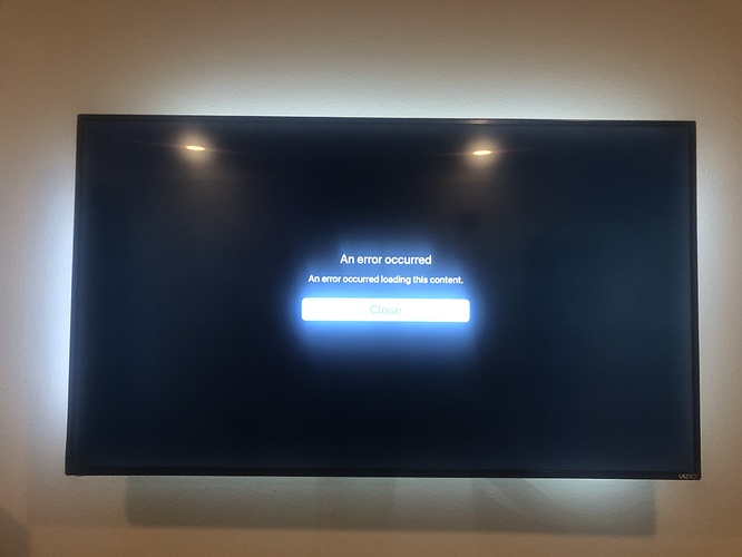

When I try to play a file from my Infuse library, I just get an error saying error occurred loading this content.
i hhad used infuse on my apple tv in the past with no issue connecting to my plex server

I am seeing an error about Plex Relay being active
Plex Relay is a service provided by Plex for remote streaming. It has a low bandwidth cap, so using it can lead to playback issues.
It’s possible to avoid using this by disabling the service on your device, and more info on some ways to do this can be found here.
If you are streaming locally, Plex may be incorrectly routing traffic through its relay service (which is not necessary on a local network). In this case, you may try restarting your Plex server device.
It would seem there may be something related to the network that is blocking local access. If you can submit a report from your device (and post the 5 digit code here) we can look deeper into this.
Ok, reverting back to the previous version of plex solved everything. So dont use PMS 1.32.0.6918, it has a bug that makes the server seem remote, even when it’s not.
