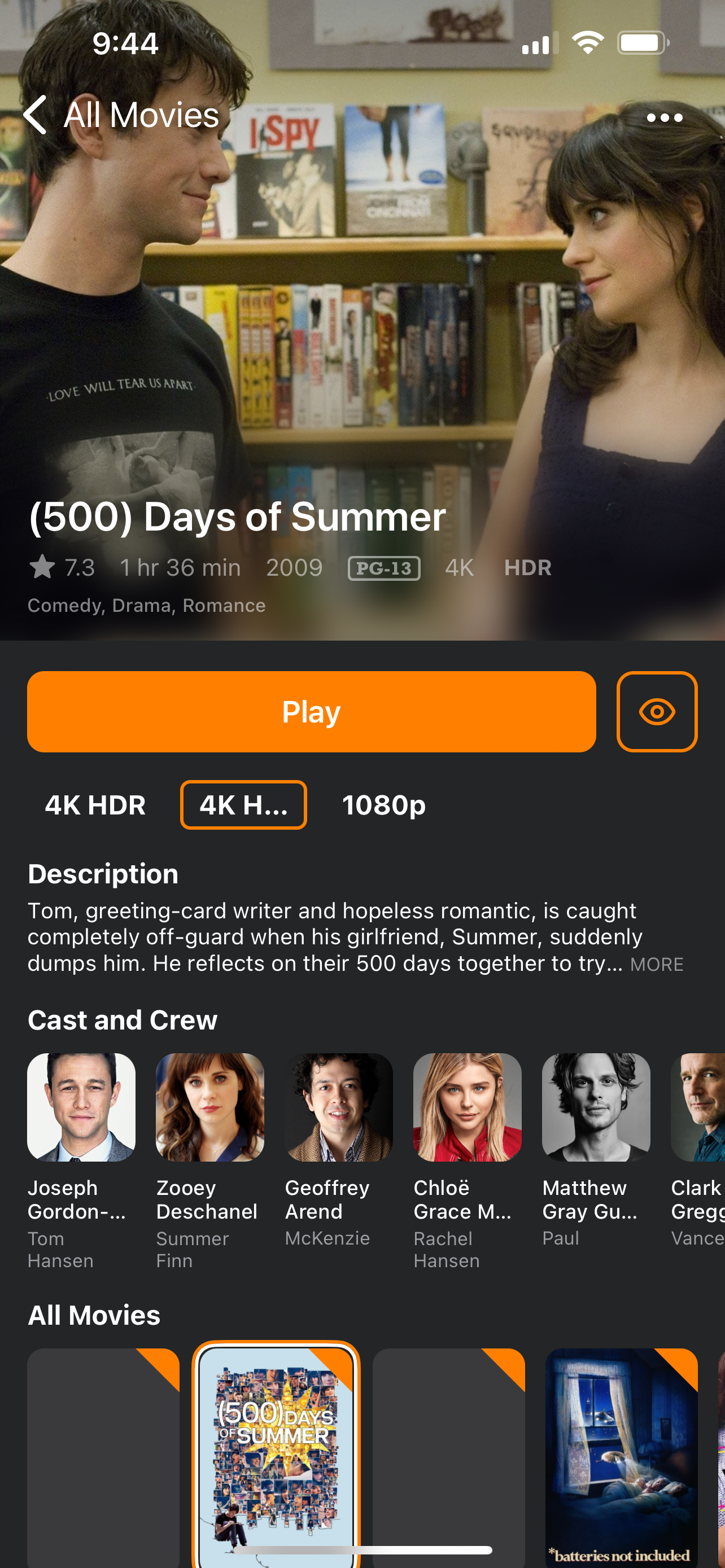

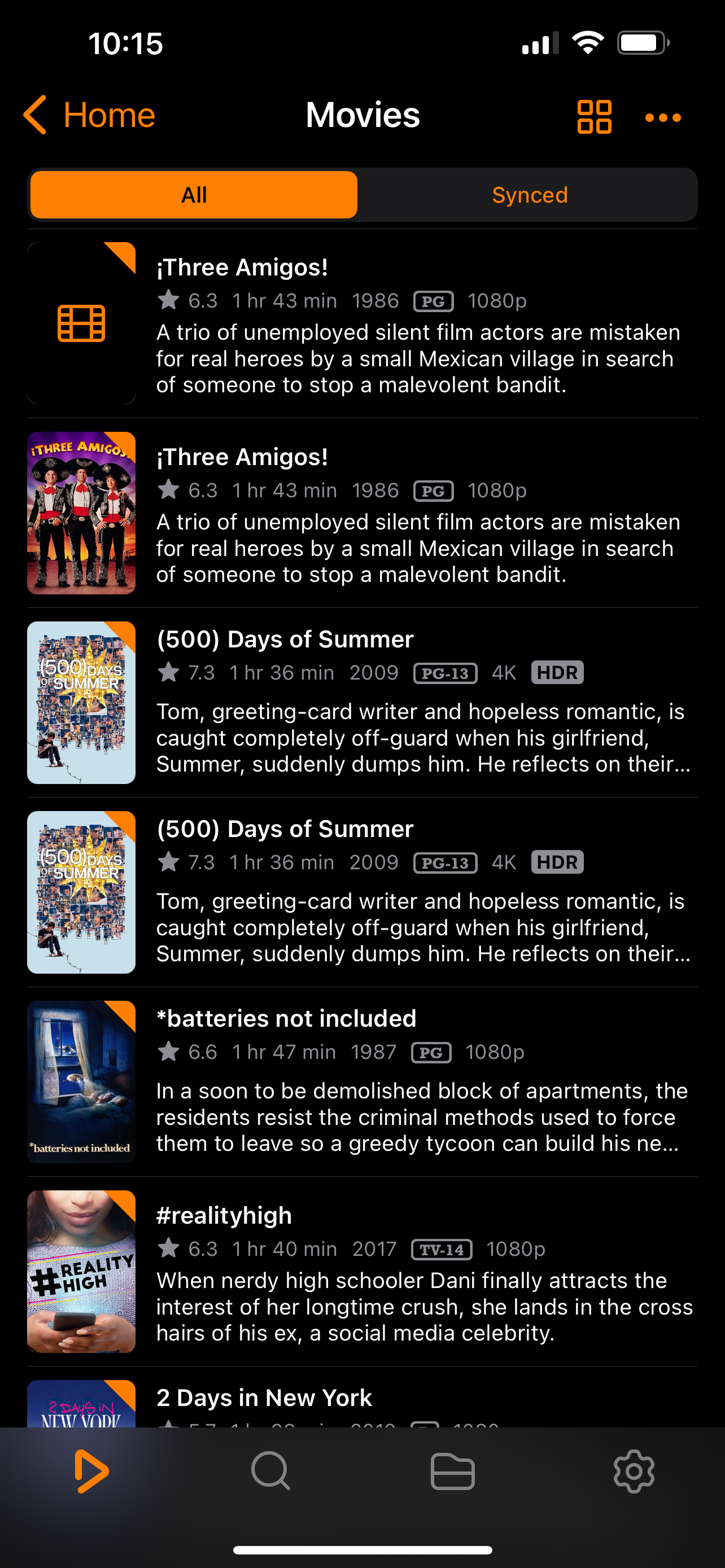

I checked my versions and they match yours. I installed Infuse on my Mac this morning and the library info synced from iCloud. See the attached screen shots from the the Mac and also from my phone. The Mac and Apple TV are reporting the same data but the iPhone thinks there are three copies (two 4ks) and one (1080p). I my non 4k and 4k copies are in different library folders. I checked both and there are only two copies: 4k and non-4k. Should I remove the library and add it again? Maybe something is corrupt or there is a detection issue?
Don’t let me derail this but do you by any chance have a copy or copies downloaded to the iphone so it may be seeing local files for it in addition to the streaming library?
Yes, I think I have the extra copy resolved from the phone. I moved to Jellyfin from Plex and the phone still had a plex library connected. I removed that and now I see two copies as shown. Now it shows both “4k” copies like the other devices. Very strange.
