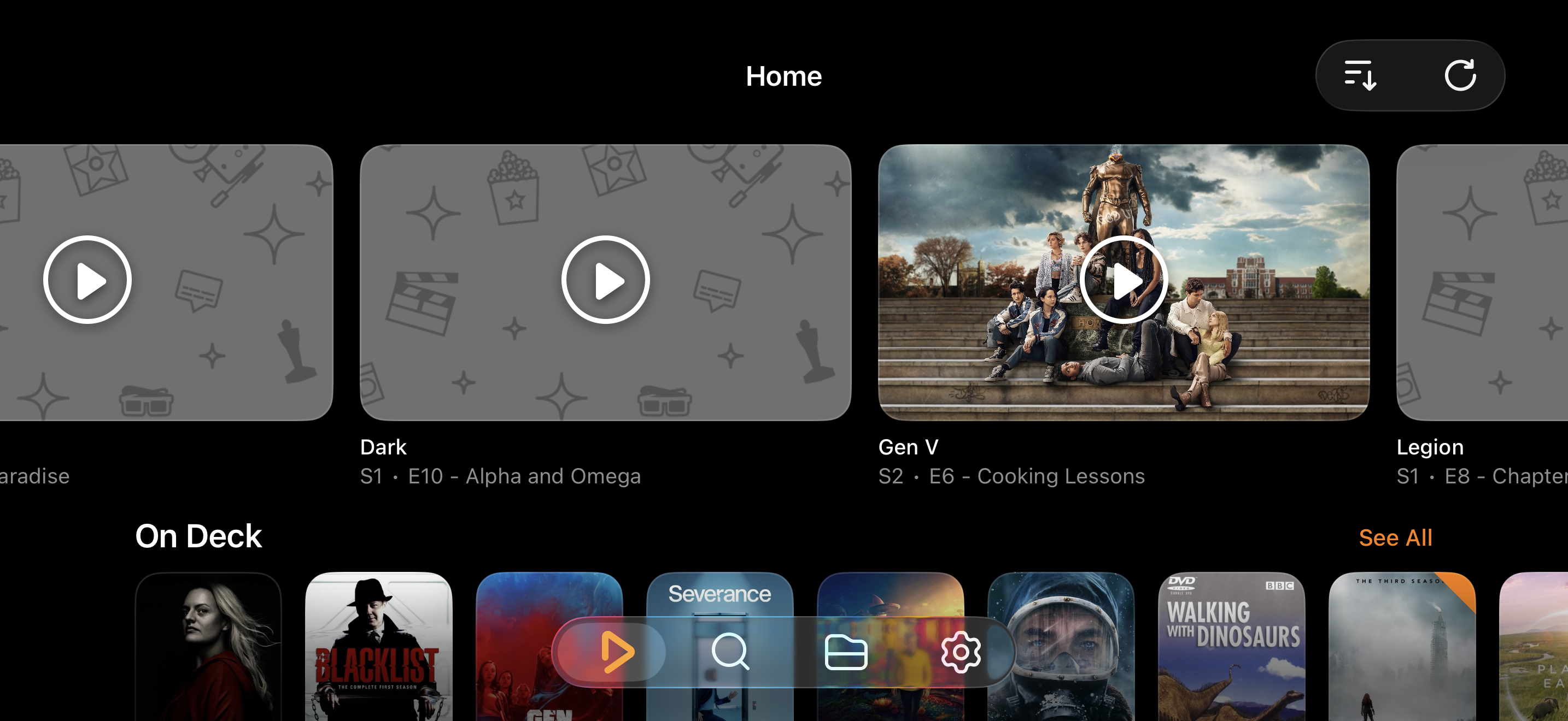

Hello! Looking for some clarity on getting show art to work in the Watching row for all devices and in the Apple TV preview area on tvOS. Infuse and all its apps are latest, with Jellyfin 10.10.7.
Watching thumbnails and the preview area are just grey for all shows, but somehow movies work. Examples here and below. Everything is matched right in Jellyfin, and art appears in Infuse, just not in those areas.

I must say, this issue is really annoying. I’m in the same situation: Jellyfin, library mode. For some unknown reasons, the backdrop for any new series added to Jellyfin is not loaded in Infuse.
In yours, is that Gen V episode only working because you put a png in there manually?

I think that Gen V episode has an artwork because the series loaded the artwork on previous episodes before it stopped working. Dark is a series I just loaded, and no artwork (but there is one in Jellyfin)… Something got recently broken between Jellyfin and Infuse

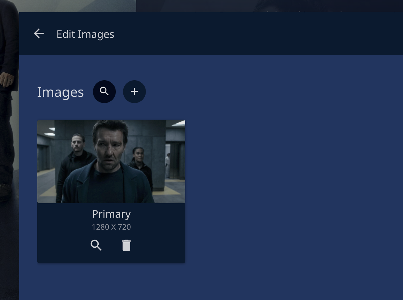

@NC_Bullseye can you tell me what images need to be embedded in the files or downloaded for Watching images to show up?
Checking in Jellyfin, I have Primary, Logo, and Thumb embedded for show art and then only Primary for season and and individual episode art. The attached is for a single episode. I do not get Backdrop downloaded when I scan a Jellyfin show.

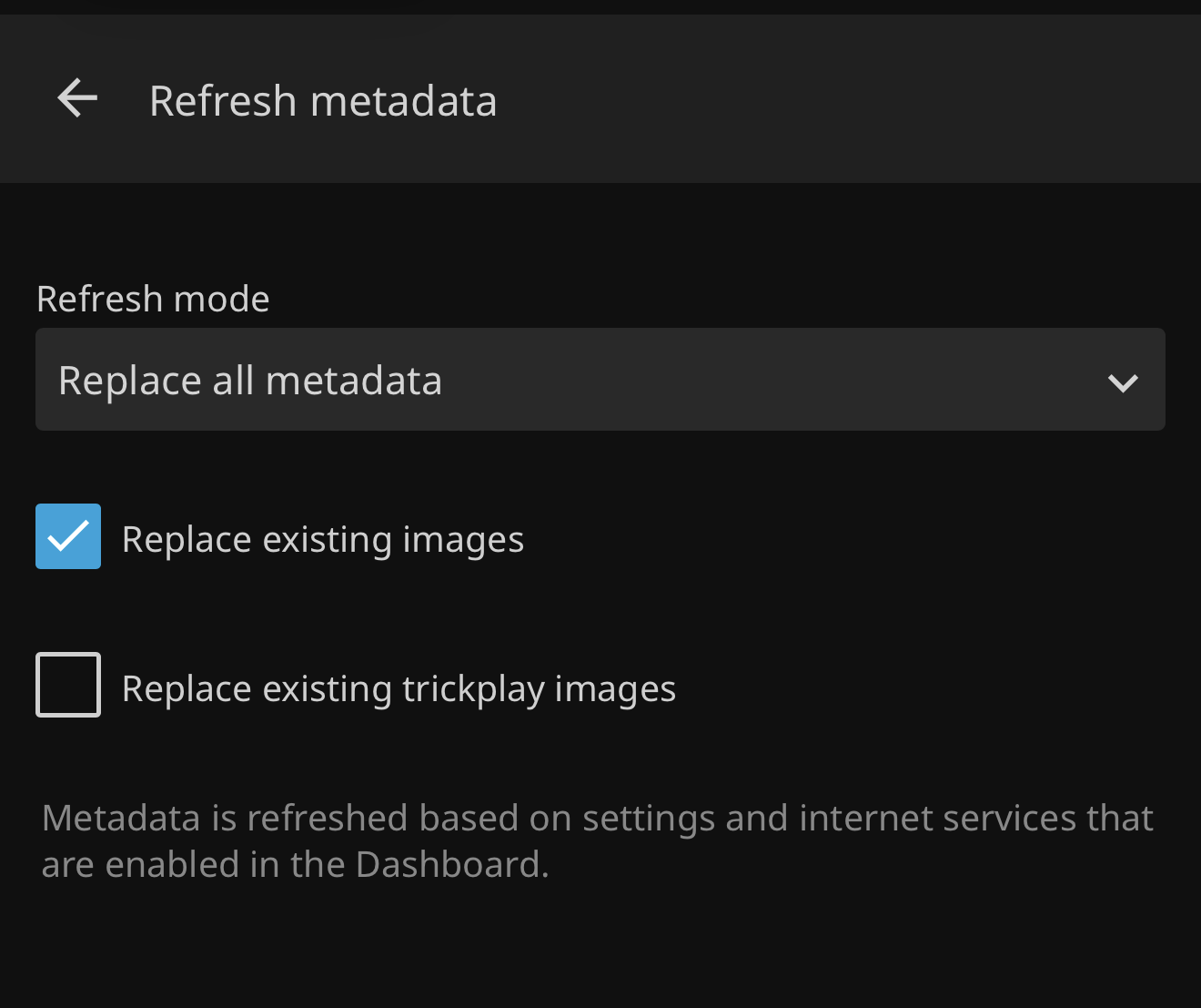

This is fixed on Jellyfin/TMDB side. I confirmed on my installation today.
You may need to refresh metadata on the desired libraries on Jellyfin, replacing existing images to force a full refresh.

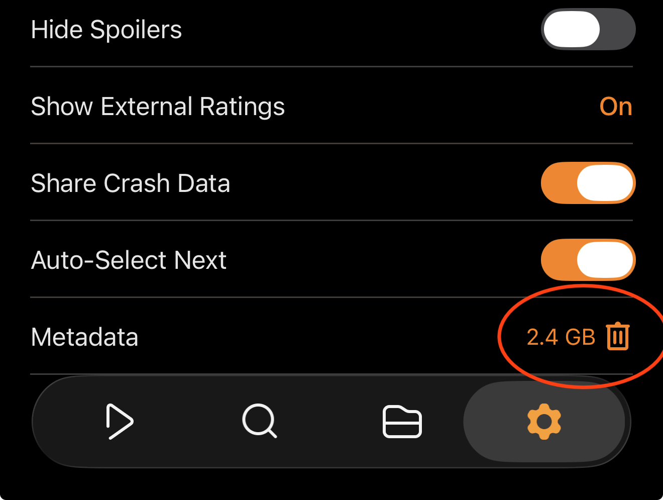

Then for good measure you may want to delete all metadata from Infuse and let it download everything again, it takes a few minutes but then everything is clean.
Hope this helps
Replace all metadata was it… wow, can’t thank you enough! I missed that, looks like without it Jellyfin doesn’t add new art at all. Since I stood up the server after this API change (switching from Plex), I never had backdrops to begin with.
