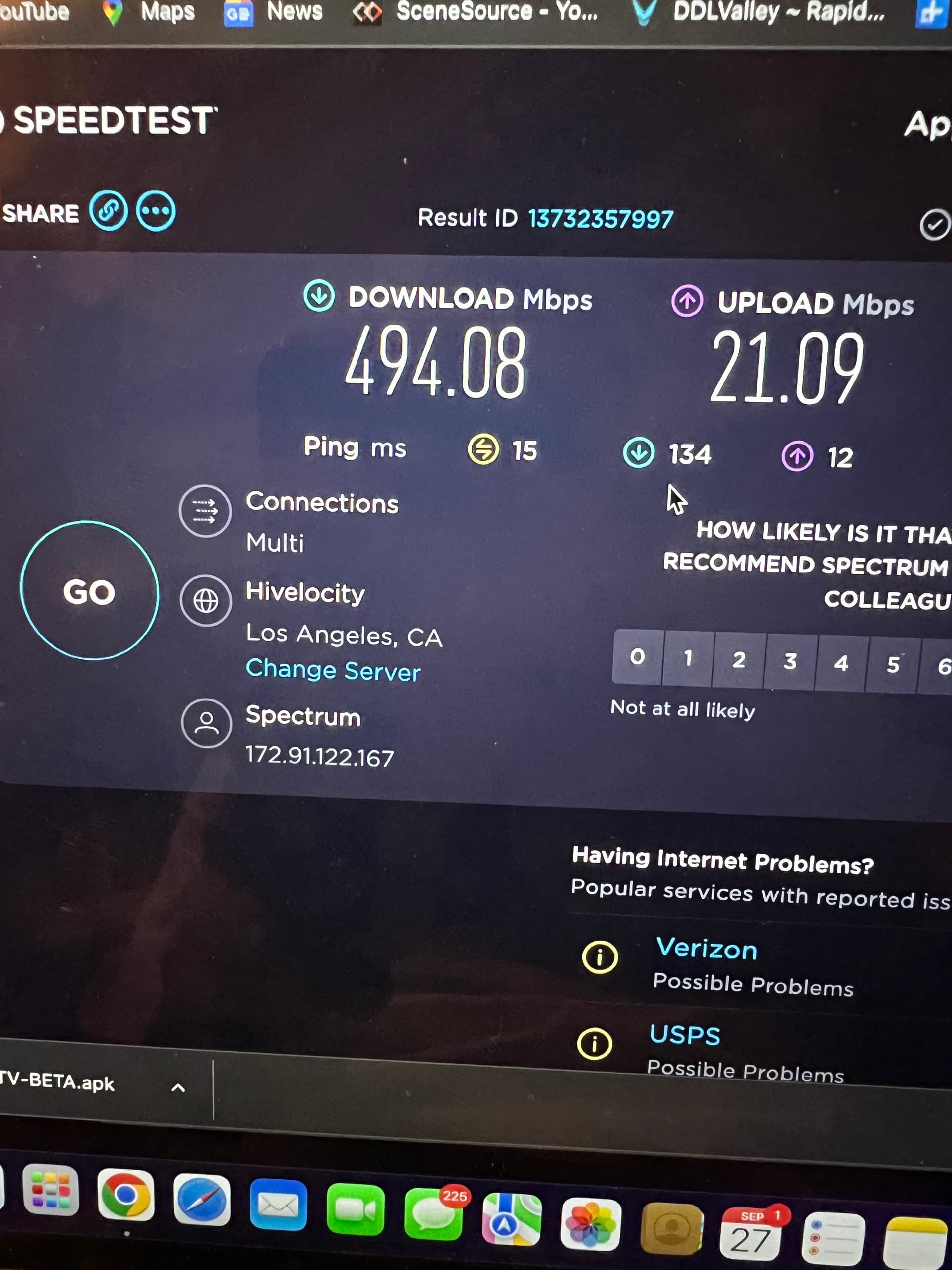

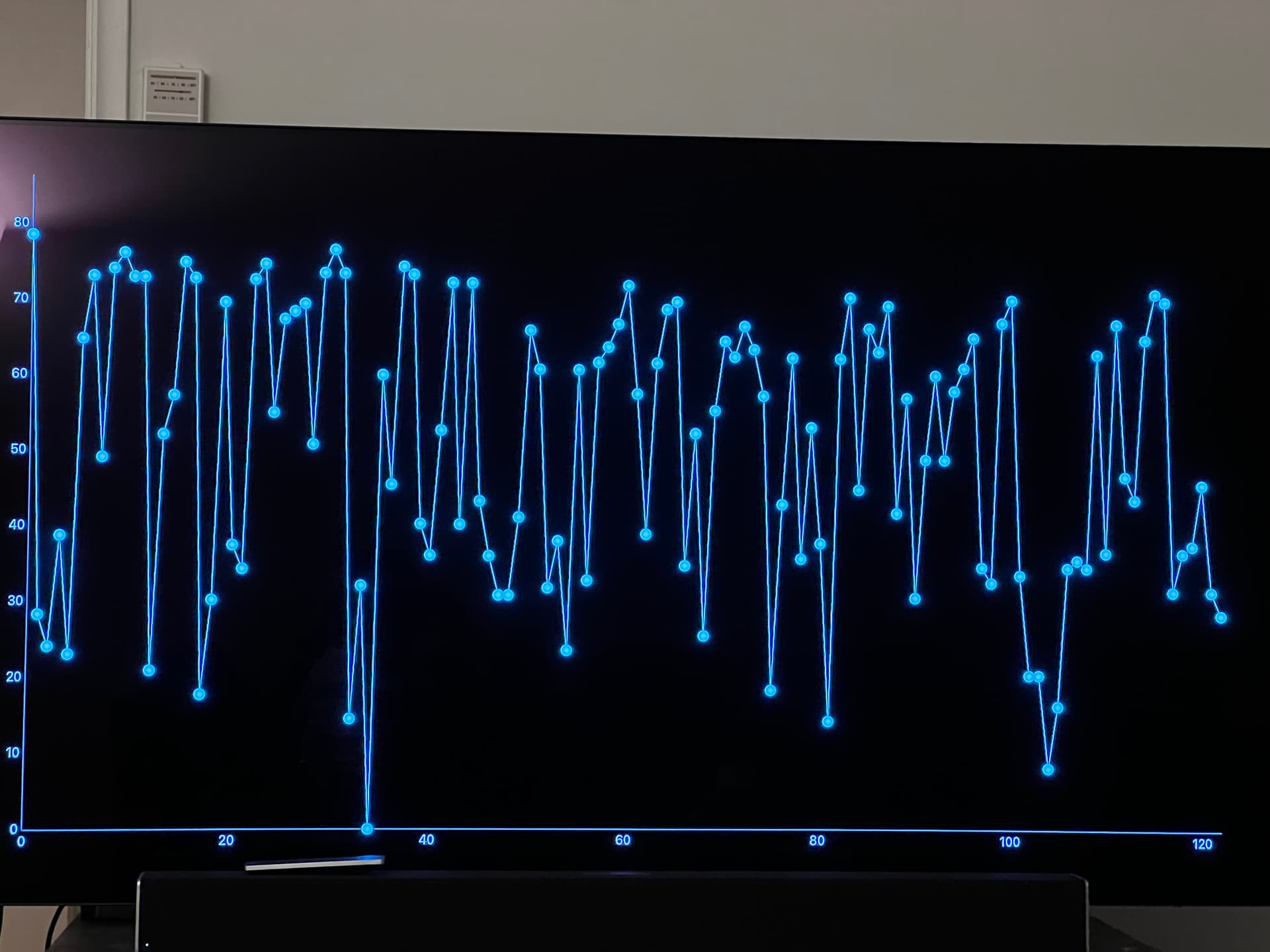

Speed test to file
Speed test on MacBook

Based on your Speedtest you probably have some issues with the WiFi. If possible use Ethernet for best performance. Most likely higher bitrate items will buffer.

I’m surprised that wofo is so bad and speed test is so high how does that makes sense ?

Keep in mind the speedtest app tests your internet speed where the Infuse speed test simulates the needed process for streaming video. so the numbers will be lower in Infuse.
One big issue I see in your graph you posted is the wild rapid swings in speed so something is up there with your local net settings.
